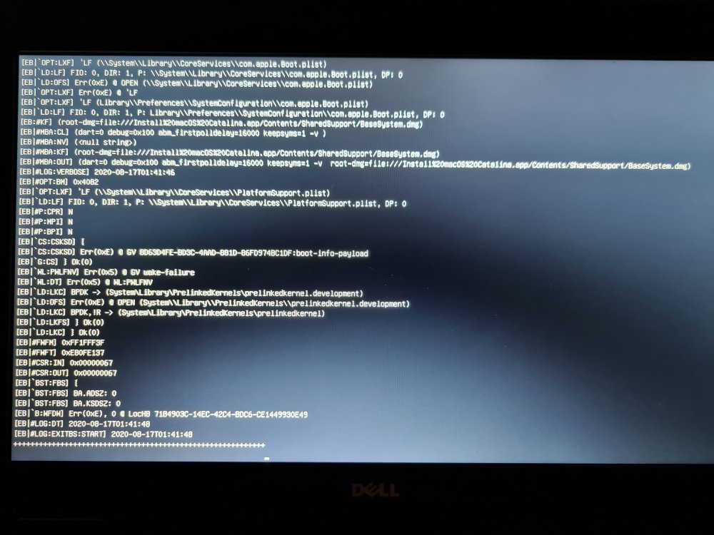

rexlcd Posted August 16, 2020 Share Posted August 16, 2020 Hi! I've been trying to install Catalina 10.15.6 for the last 2 days and I can't seem to get around this error no matter what I do. My laptop is a Latitude E7240 with an i5-4300U and 1366x768 screen. I followed your Catalina Clover Guide and I used Clover v5119, your E7440_Catalina bootpack and I updated all the kexts to their latest versions, but to no avail. I attached my EFI folder along with a screenshot. Thank you! EDIT: I have read the other posts and I tried all those solutions but nothing worked. I tried booting with a SATA SSD, I have no wifi card installed and nothing plugged in the computer except the USB installer stick. I also tried the -igfxvesa arg, but no success. EFI.zip Link to comment Share on other sites More sharing options...
Moderators Jake Lo Posted August 16, 2020 Moderators Share Posted August 16, 2020 You're missing ApfsDriverLoader.efi and AptioMemoryFix.efi Make sure go through the drivers directories. Link to comment Share on other sites More sharing options...
rexlcd Posted August 16, 2020 Author Share Posted August 16, 2020 I used the Clover Builder v5.0_r5119 from here https://github.com/Dids/clover-builder/releases and ApfsDriverLoader.efi and AptioMemoryFix.efi are not through the drivers directories unless I am missing something. Link to comment Share on other sites More sharing options...
rexlcd Posted August 16, 2020 Author Share Posted August 16, 2020 I added them manually into the EFI folder from an older Clover 2.5k install since the new one doesn't include these and now it works... I wonder why they don't include them anymore with the newer builders. Link to comment Share on other sites More sharing options...
Moderators Jake Lo Posted August 16, 2020 Moderators Share Posted August 16, 2020 Yes they are moving to OCquirks, getting ready for Big Sur. Here, replace your drivers folder with mine drivers.zip 1 Link to comment Share on other sites More sharing options...
rexlcd Posted August 17, 2020 Author Share Posted August 17, 2020 It works now. Thank you very much! Link to comment Share on other sites More sharing options...
