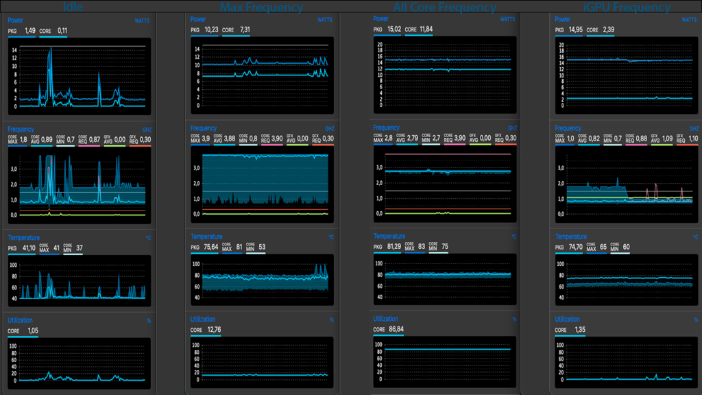

  • All Sensors CPU, IGPU, BATTERY, NVME, FAN
