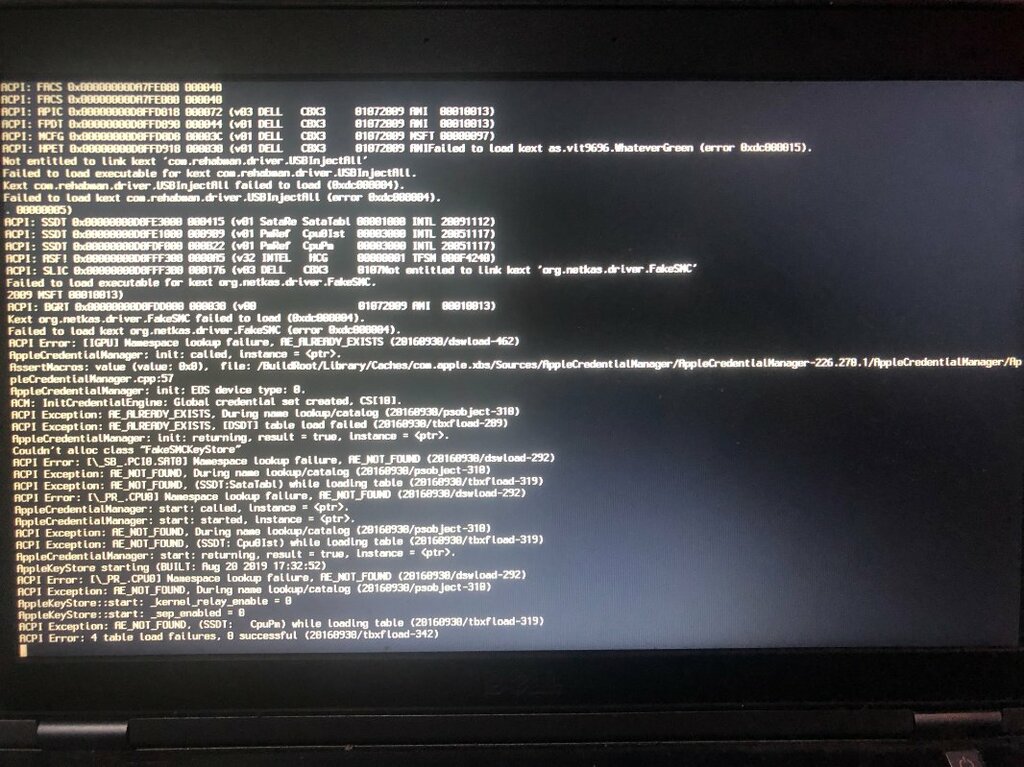

balrzoz Posted March 9, 2021 Share Posted March 9, 2021 Hi, I'm new to the hackintosh scene, tried to do hackintosh Mojave on my Dell E6230 I was using Jake Lo's guide to do it, and stuck on Quote ACPI Error: 4 table load failures, 0 successful (20160930/tbxf load-342) screenshot is attached. EFI folder is attached as well, I'm using Clover_v2.4k_r4920. if it's important I'm using vmware mojave for creating Bootable USB. thanks in advance. EFI.zip Link to comment Share on other sites More sharing options...
Administrators Hervé Posted March 9, 2021 Administrators Share Posted March 9, 2021 Link to comment Share on other sites More sharing options...

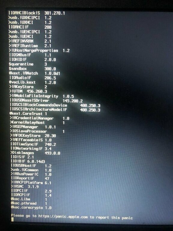

balrzoz Posted March 9, 2021 Author Share Posted March 9, 2021 (edited) Oh wow, how did I missed this, Thank you so much. sorry for not looking hard enough will try it right now! I'm excited! -------------Update------------- I was able to boot it correctly with @Hervé guide, without ACPI error and stuff, but this time I get rebooted from the verbose mode, then I googled and turn the do not restart if panic option. At the end of the process it says "Please go to https://panic,apple,com to report this panic", trying to search for solution. Edited March 9, 2021 by balrzoz Link to comment Share on other sites More sharing options...

balrzoz Posted March 10, 2021 Author Share Posted March 10, 2021 I was using your BIOS settings guide and then some things change after updating driver, then tried it again this morning still stuck on panic. this is the screenshot of the end of the process. also EFI files is attached, I think there's nothing wrong with the EFI, the guide is clear as day. tried to switch out the installation from another USB port still doesn't work. Also in the guide there's 2 FSInject on the UEFI driver but I can only find one. Quote UEFI Drivers AudioDxe DataHubDxe FSInject SMCHelper ApfsDriverLoader AptioMemoryFix Fat FSInject PartitionDxe Ps2MouseDxe UsbMouse.Dxe VBoxHfs EFI.zip Link to comment Share on other sites More sharing options...
Administrators Hervé Posted March 10, 2021 Administrators Share Posted March 10, 2021 Obviously just a typo that has now been attended for; thanks for pointing this out. We won't be able to make anything out of that KP screenshot unfortunately. Things that could be wrong, open thoughts really: dodgy RAM module or slot unsupported wireless card; please specify non-vanilla installation You should also post your specs in signature like most of us do. Link to comment Share on other sites More sharing options...
balrzoz Posted March 10, 2021 Author Share Posted March 10, 2021 (edited) I see, now that you pointed it out, I was careless my CPU is i5-3320M it's completely different from the guide but it still E6230. different region problem I think. Ram is 12GB DDR3L different brand too wireless card in my device manager Intel® Centrino® Ultimate-N 6300 installation is from VM macOS mojave - download from appstore. Is there anything I can do to make this work? I'll try to move out i5-3340M_SSDT.efi and try to boot it again. Signature is updated, ----Update---- still stuck on panic. still looking for another solution Edited March 10, 2021 by balrzoz wrong wireless card Link to comment Share on other sites More sharing options...
Administrators Hervé Posted March 10, 2021 Administrators Share Posted March 10, 2021 No need to switch to the other bootpack. As stated in the guides you simply need to generate your CPU-specific power management SSDT. Granted it may not have been explained well-enough, something I've now addressed. If you use the SSDTs for I provided for the CPUs stated in my guides, you'll indeed encounter issues. Anyway, assuming you're unable to generate your own SSDT, here it is. Just unzip and place inside your Clover's ACPI/patched folder. SSDT-PM_i5-3320M.aml.zip Link to comment Share on other sites More sharing options...
