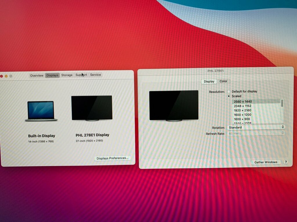

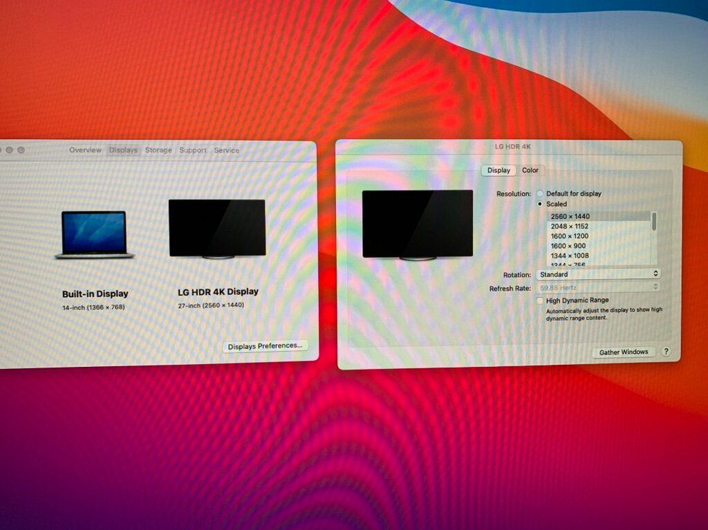

ryuu_nami Posted April 30, 2021 Author Share Posted April 30, 2021 @Jake Lo I noticed that you've change my model to macbook pro 15,4. Did you change something else except the model? It does work. But there are flaws. HDMI and DP only work when hot-pluged. It doesn't work when cold-pluged. It seems that HDMI and dp port don't recognized my display properly. I have a philps and a lg diskplay. Both of them are 4k display. But the port recognized my philps display as a 1920X2160 display(lg as 2560X1440). It's really weired. Although I can manaully overide the setting and change to other display mode. But Both of my display can only use 2k(2560X1440). I've attached screenshots to show what i mean. Does it limited by my hardware or i can change some settings to get 4k work. Both my display are working as a 4k monitor under windows. Any ideas? Thank you! Link to comment Share on other sites More sharing options...
Moderators Jake Lo Posted April 30, 2021 Moderators Share Posted April 30, 2021 Try this config.4K.zipFetching info... Link to comment Share on other sites More sharing options...
ryuu_nami Posted April 30, 2021 Author Share Posted April 30, 2021 @Jake Lo I upgrade my opencore to 0.68 , add a gui to boot screen and cope with cursor jumping problems. I also change my smbios info. So I've done a lot of changes to my config.plist. I did a "diff" on your config.plist and mine and found out that you've change the video memory to 2048 and add a "-cdfon" to the boot argu. I modifed my config.plist accordingly and it doesn't work. ONLY 2k no 4k. I attached my current config.plist file. If you want to make some changes, please modifed this version. So I don't need to redo all the modification I've done. Thank you. config.plist.zipFetching info... Link to comment Share on other sites More sharing options...
Moderators Jake Lo Posted April 30, 2021 Moderators Share Posted April 30, 2021 At this point, I think you might just have to try changing the DVMT pre-alloc to 128MB Link to comment Share on other sites More sharing options...
