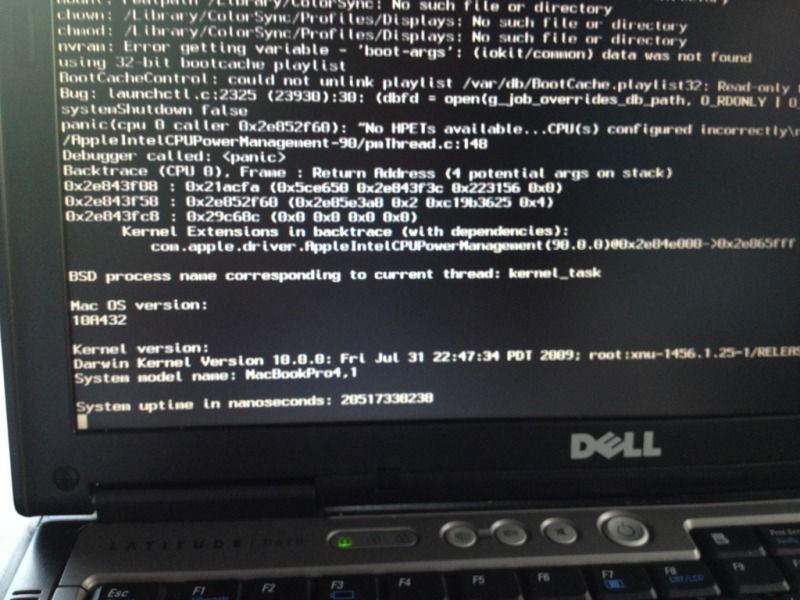

adam Posted July 28, 2012 Share Posted July 28, 2012 I am about to give up! I am a total noob, I have read pages and pages over the past couple of weeks and I am not getting anywhere! I feel like smashing my D620 up. I have followed the guides word for word and keep getting this message with Lion or SL... What am I doing wrong?? Link to comment Share on other sites More sharing options...

Administrators Syonagar Posted July 28, 2012 Administrators Share Posted July 28, 2012 Dear Adam, Have you installed the bootpack for your D620? Are you booting from usb or the hard disk? It seems that NullCPUPowerManagement.kext is not installed in your /Extra/Extensions. Go to /Extra/Extensions and see if the kext is installed. Cheers! Link to comment Share on other sites More sharing options...
adam Posted July 28, 2012 Author Share Posted July 28, 2012 I am using myhack and the correct boot pack. Everything I try results in the same as above. Link to comment Share on other sites More sharing options...
Administrators Syonagar Posted July 29, 2012 Administrators Share Posted July 29, 2012 Dear adam, Have you ran myfix full mode on the os x partition? Cheers! Link to comment Share on other sites More sharing options...
Administrators Hervé Posted July 29, 2012 Administrators Share Posted July 29, 2012 Which BIOS is your D620 running and could you check the BIOS settings, namely SpeedStep? Link to comment Share on other sites More sharing options...
adam Posted July 30, 2012 Author Share Posted July 30, 2012 Updated bios, getting closer... Link to comment Share on other sites More sharing options...
Administrators Hervé Posted July 30, 2012 Administrators Share Posted July 30, 2012 How much memory do you have in that D620? It would really help to know the full specs of your machine like some of us indicate in our signature (model, CPU, RAM Qty, HDD size, graphics card, screen resolution, etc.). Link to comment Share on other sites More sharing options...
adam Posted July 30, 2012 Author Share Posted July 30, 2012 How much memory do you have in that D620? It would really help to know the full specs of your machine like some of us indicate in our signature (model, CPU, RAM Qty, HDD size, graphics card, etc.). D620, 2 GB Ram, GMA 950, 80GB HDD, C2D T5300 533Mhz. Link to comment Share on other sites More sharing options...
