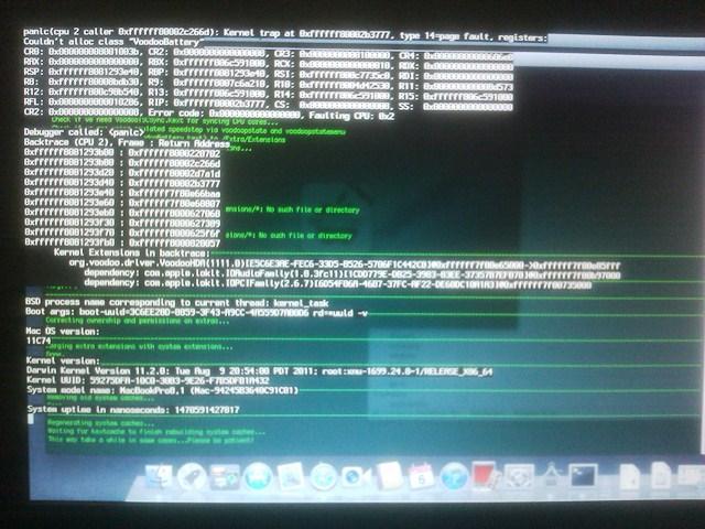

kobaugilo Posted August 6, 2012 Share Posted August 6, 2012 hello, before installation of EDP 1- ethernet (work) 2- bluebooth (work) then i choose > latitude e6220 **according to crew e6320 has same spec with e6220 so i go with that suggestion during installation system crash! reboot system, then 1) bluebooth (working) 2) ethernet (not working) 3) sounds (not working) 4) keyboard & mouse (not working) 5) wifi (not working) any help is really appreciated. TQ Link to comment Share on other sites More sharing options...
Administrators Syonagar Posted August 6, 2012 Administrators Share Posted August 6, 2012 Dear koba, Looks like the kp is caused bt voodoohda.kext. Try to remove voodoohda.kext from /Extra/Extension. Let me know how far it goes this time? Cheers. Link to comment Share on other sites More sharing options...
kobaugilo Posted August 7, 2012 Author Share Posted August 7, 2012 syonagar, thank you for the advice. now sound is working great! to update my hardware working -------- 1) sound 2) ethernet not working ----------- 1) keyboard 2) mouse 3) wifi 4) ATA 5) bluetooth 6) PCI cards 7) power management any help is very much appreciated. TQ Link to comment Share on other sites More sharing options...
Administrators Syonagar Posted August 7, 2012 Administrators Share Posted August 7, 2012 Dear koba, You intel wifi is not supported by os x. You need to replace it with a supported broadcom one. Have you install EDP for E6220? If you have try to repair permission with disk utility and run myfix full mode. Cheers! Link to comment Share on other sites More sharing options...
