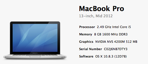

DraKuL71 Posted April 10, 2013 Share Posted April 10, 2013 Since the e6520 can vary a little bit, such as processor type, graphics, etc. the one I am working on has the configuration shown. Link to comment Share on other sites More sharing options...
