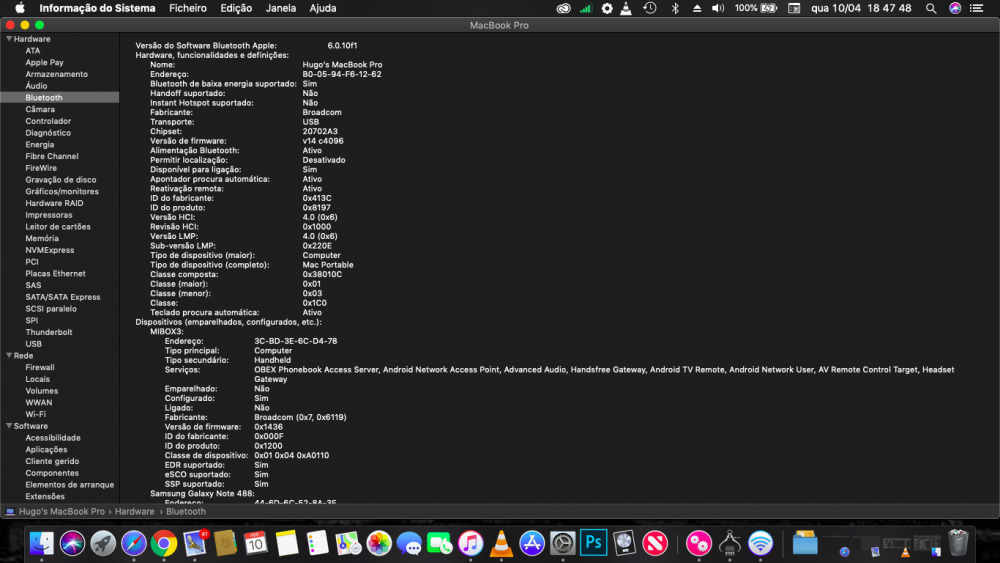

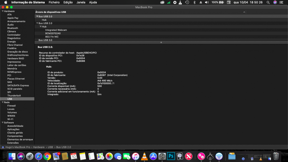

hcardoso483 Posted April 10, 2019 Author Share Posted April 10, 2019 (edited) We are so close so close Bluthooth is WORKIKNG And after sleep WIFI is flashing the indicator light on the top of the palmrest right beside the disk activity light, Thank You Thank You Thank You, we are so close, what shold i do i am afraid to Fªªk Up at this stage, you are a GENEUS MEN. WWOWW Thank YouThank YouThank You MacBook Pro.spx.zip Edited April 10, 2019 by hcardoso483 To Include system report Link to comment Share on other sites More sharing options...
Administrators Hervé Posted April 10, 2019 Administrators Share Posted April 10, 2019 I don't know what more you expect... I ask you something, you reply something unrelated... All in all, it seems you do not have any mini-PCIe wireless card but are running on the built-in DW380 BT 4.0 module and a TP-Link TL-WN821N v5 USB dongle for wifi. Nothing further to add, I guess your done. Link to comment Share on other sites More sharing options...
