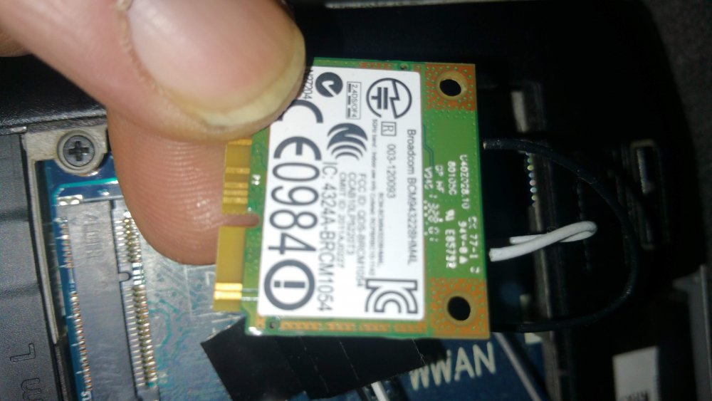

hcardoso483 Posted April 10, 2019 Author Share Posted April 10, 2019 Let's see if i got it righ sorry i wasn't understanding i though that all e6230 had the same wi-fi card: I took this one out and looked : BCM943228HM4L IC: 4324A-BRCM1054 Link to comment Share on other sites More sharing options...

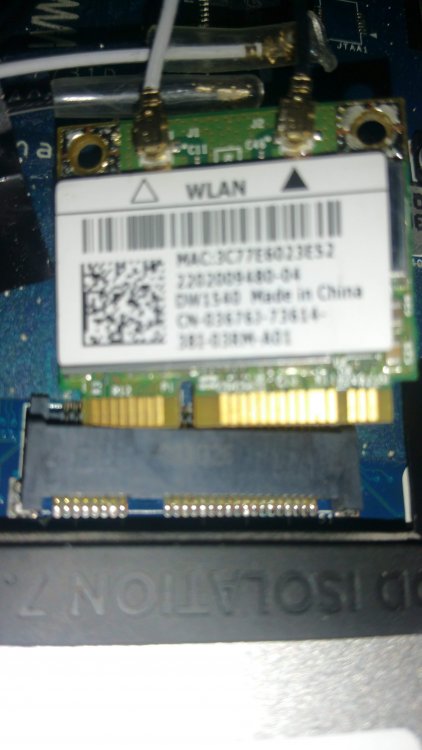

Administrators Hervé Posted April 11, 2019 Administrators Share Posted April 11, 2019 No, not all E6230 are fitted with the same card.... As written on the labels; it's a Dell DW1540, based on Broadcom BCM43228. It's listed in our inventory (link provided above) and you're out of luck, sorry. Link to comment Share on other sites More sharing options...
