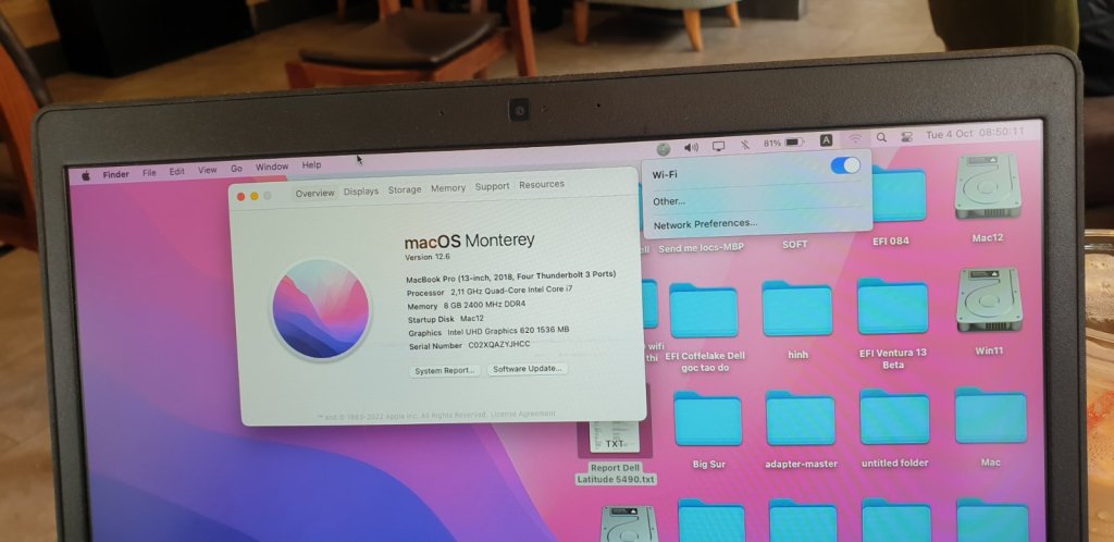

phamdinhloc Posted October 4, 2022 Share Posted October 4, 2022 @Jake Lo thank you for sharing the EFI you posted here. I used it for my Dell 5490 laptop and it gives very good results, but wifi doesn't show any network to connect, touchpad works fine but buttons on touchpad mouse not working. Can you help me Fix it? Thank you very much. Configuration: Intel i7-8650U Intel UHD Video 620 8GB ram DDR4 2666 Wifi Intel Wireless-AC 8265 Reveal hidden contents Link to comment Share on other sites More sharing options...
Baio77 Posted October 9, 2022 Share Posted October 9, 2022 For trackpad check the pictures in this reposity, set as in the picture and try https://github.com/Baio1977/DELL_VOSTRO_5501-ICE-LAKE/blob/main/Screenshot/touchpad.png For WI-FI use kext for Monterey https://github.com/OpenIntelWireless/itlwm/releases/tag/v2.1.0 and BT https://github.com/OpenIntelWireless/IntelBluetoothFirmware/releases . Don't use this kext on Monterey or higher IntelBluetoothInjector.kext. Use this kext for Monterey+ BlueToolFixup.kext 1 Link to comment Share on other sites More sharing options...
