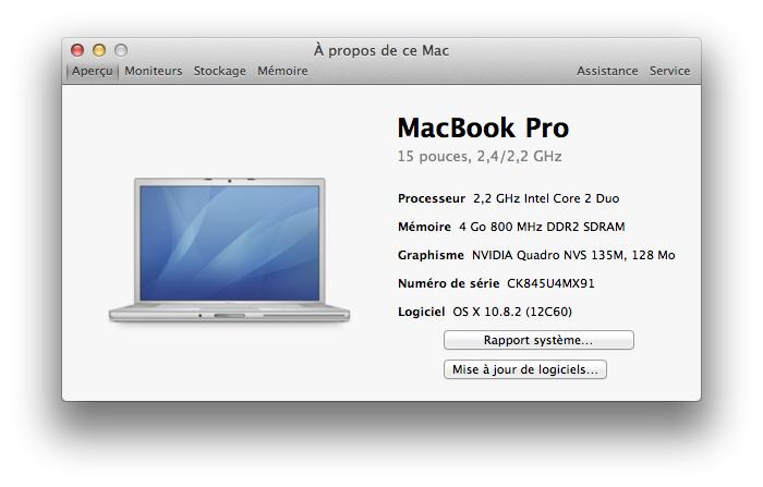

2. It says that my graphics card is the 8400M GS 128MB but I think it's a Quadro.

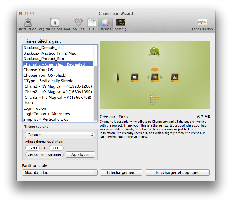

Is there a fix for these? Also, I'm using the USB as a bootloader but I'd like to install chimera (chameleon, stolen and rebranded) instead of Chameleon because I prefer the look of it. Will that cause any issue?

Good that you met success on that D630. To answer your points:
1) BT will only work if the adapter's radio was enabled within Windows, BT blue LED being lit permanently. Otherwise, the adapter's ROM/radio is disabled and you cannot activate it from Mac OS, not even from the laptop's BIOS.
2) Correct, the D630 nVidia is fitted with a Quadro NVS 135m (or 140m). When you ran EDP, the DSDT file was replaced and the new one refers to the 8400M as opposed to the NVS 135m, but I believe that is just cosmetic. What you can do is replace your current DSDT file by the file from the bootpack and your Hackintosh will report the right model. That's what I did on my D630 and look:
I don't know about chimera (chameleon, stolen and rebranded), but you can change the look of Chameleon too. If you install Chameleon Wizard, you'll see the various themes available:
