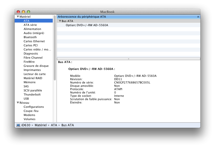

One of my intel D630s refused to sleep. The screen would dim but sleep never followed. After a lot of cache clearing, sleep fixes, EDP re-running, etc I started to look at the hardware.
Luckily I have several of these machines so was able to swap parts to test. In the end it was the DVD drive that was causing the issue. I have no idea if it needs some kind of firmware update or if it is faulty - it functions fine in Windows 7 - I just swapped it for a drive from another non-mac running unit and normal sleeping has been finally achieved.
