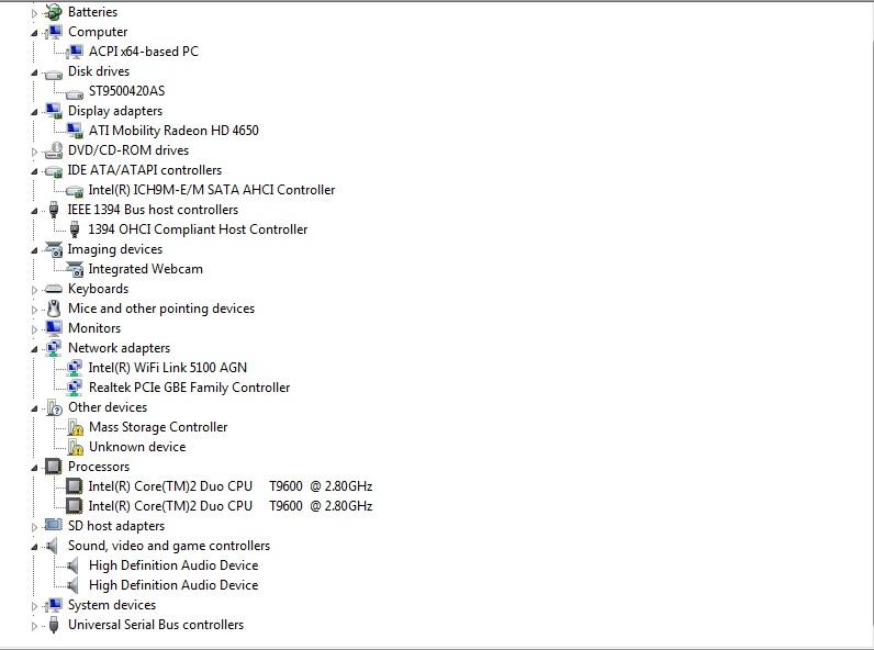

sturza Posted November 26, 2012 Author Share Posted November 26, 2012 Hi, it would help to know the hardware specifications + BIOS settings of your system... Is that a laptop or a desktop? Then who knows how you installed ML (other than with multifail)? I mean what kexts did you install, what bootloader, etc ? this is my configuration Link to comment Share on other sites More sharing options...

Administrators Hervé Posted November 26, 2012 Administrators Share Posted November 26, 2012 You should also find info about your laptop's hardware in the BIOS settings. Your CPU is good. You'll have to confirm chipset (should be visible in the BIOS) Your Graphics card appears supported: http://www.osx86.net...for_10._...html Your Sound card (IDT 92HD73C) should be Ok: http://www.osx86.net...do=file&id=2223 http://www.osx86.net...do=file&id=2809 You'll need to replace your Intel wireless card as it will not be supported. For the bootloader, try and re-install whatever you've used or Chameleon (if that is possible off a multifail installation). Link to comment Share on other sites More sharing options...
