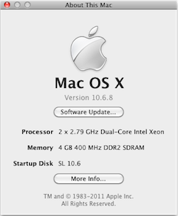

With Paxville dual-core Xeon in place, I was able to install Lion with myHack using Bronya's RC13 AMD kernel + boot pack from my previous SL installation. I installed Lion 10.7.2 with myHack v3.1.2 + 10.7.5 Combo update. System seems to have an issue with native power management, so I had to revert to NullCPUPowerManagement to stabilize things. Other than that, everything seems to be working well, except Sleep (probably needs Lion-specific SleepEnabler kext). Running in 32bit mode to retain Intel LAN + AC'97 audio support.

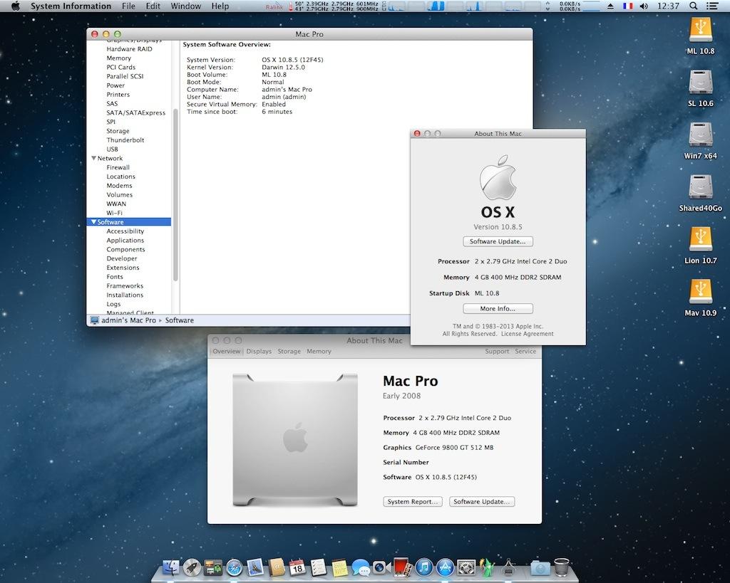

Ho, ho, ho, things are getting interesting. ML running with Bronya's RC5 AMD kernel... I installed ML 10.8 with myHack v3.1.2 + 10.8.5 Combo update.
64bit mode naturally so no support for built-in LAN (old Tiger kext is 32bit only) and AC'97 audio atrociously buggy (getting really bad crunching sound bug with every audio playout) but everything else seems to be working Ok. Sleep/wake natively fully functional. Full QE/CI too.

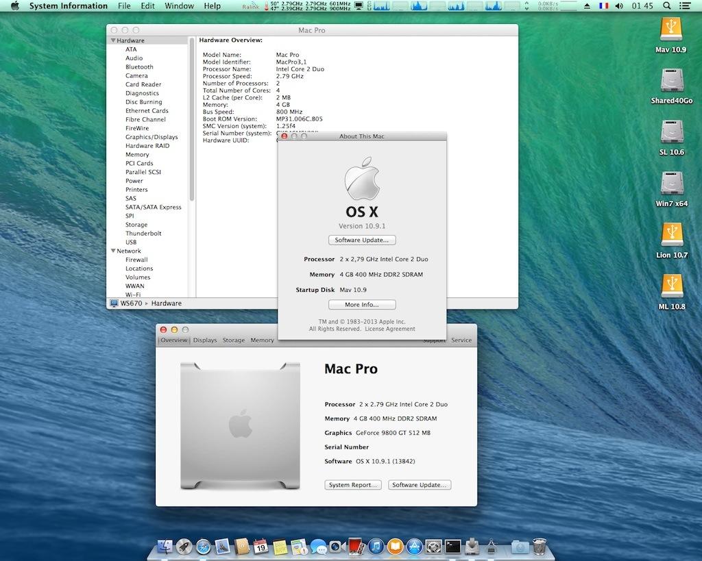

Went through Mavericks 10.9.1 installation with myHack v3.3.1 using Bronya's 10.9 RC7 AMD kernel. Apart from the known 64bit-related AC'97 audio bug, everything appears to work ok, including sleep, wake and full QE/CI but I've noticed some little graphics defects around the names of Desktop items. Again, I'm still using the NVenabler64 next (until I sort out the DSDT because there must be an issue there) so this could be the reason.

Finally fixed the graphics injection in my DSDT patch which imposed to use the NVenabler64 kext: turned out I had 3 x typos !!!
"@0,device-type"   /* dash '-' */
"@1,device-type"   /* dash '-' */
"device-type"      /* dash '-' */
where it should have been:
"@0,device_type"   /* underscore '_' */
"@1,device_type"   /* underscore '_' */
"device_type"      /* underscore '_' */
Basically, I had copied/pasted a previous line and kept a "-" where a "_" was expected! Stupid! Now I no longer need the NVEnabler64 kext in Lion, ML or Mav. Post #6 updated accordingly. The tiny graphics defects I had on the desktop are gone too.

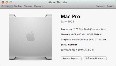

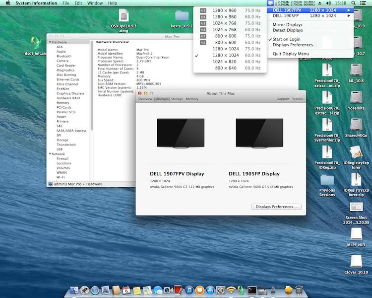

Thanks to IM member axmanA, the white screen or QE/CI lagging issue is now effectively solved. I've even updated to 10.9.4, running Bronya's 10.9.2 RC7 kernels and everything appears to work well.
As described here by axmanA , the problem was due to a combination of driver changes by Apple from 10.9.2 and nVidia some time before.
I found out I actually had to replace the IOPCIFamily kext directly in /S/L/E as OS X was ignoring the patched kext when placed in /E/E and installed with myFix (quick).
So great news: I can now boot all post-10.9.1 Mavericks version with that patched kext (Chameleon option msibase=0x90 necessary). I was able to retain MacPro3,1 settings (SMBios profile + FakeSMC keys & smc-compatible). I then reverted to IOPCIFamily + AppleACPIPlatform kexts from 10.9.1 and obtained same result (and no need to boot with msibase option):
So, I'm pleased to say that the graphics problems encountered since 10.9.2 are sorted and everything seems 100% Ok. I've noticed the odd picture corruption when doing screen dumps, but other AMD kernel users have reported the same, so it's not specific to this system.
10.9.1_IOPCIFamily.kext.zip 10.9.1_AppleACPIPlatform.kext.zip
mach_kernel_rc5.zip
mach_kernel_rc6.zip mach_kernel_rc6_fix.zip
mach_kernel_rc7.zip
Reverting to those 10.9.1 kexts also restores the ability to boot Mavericks on the Precision 670 off a USB external HDD, which was also lost from 10.9.2...
As a final note, I noticed small graphics artefacts with RC5 so dismissed that one. RC7 appeared the only version supporting proper wake from sleep (the other ones do not wake screen), so I'm sticking to that version at the moment.
