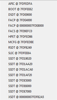

Performed Windows installation in order to use AIDA64 (last version) and have now full specs of the laptop
In resume :
  Motherboard Name   Samsung R520/R522/R620
CPU Type  Mobile DualCore Intel Pentium T4200, 2000 MHz (10 x 200)
Motherboard Chipset  Intel Cantiga PM45
Intel 82801IB ICH9
Chipset Bus Properties:       Bus Type   Intel Direct Media Interface
North Bridge Properties:       North Bridge   Intel Cantiga PM45       Supported FSB Speeds   FSB533, FSB667, FSB800, FSB1066       Supported Memory Types   DDR2-667, DDR2-800, DDR3-667, DDR3-800, DDR3-1066 SDRAM       Maximum Memory Amount   8 GB       Revision / Stepping   07 / B3       Package Type   1329 Pin FC-BGA       Package Size   34 mm x 34 mm       Process Technology   65 nm       Core Voltage   1.05 V       TDP   7 W       In-Order Queue Depth   12
South Bridge Properties:       South Bridge   Intel 82801IM ICH9M       Revision / Stepping   93 / A3       Package Type   676 Pin mBGA       Package Size   31 mm x 31 mm       Process Technology   130 nm       Core Voltage   1.05 V       TDP   2.5 W
Video Adapter  ATI Mobility Radeon HD 4300 Series (512 MB)
3D Accelerator  ATI Mobility Radeon HD 4330 (M92)
Chip Type  ATI display adapter (0x9552)
PCI Device  1002-9552 / 144D-C050 (Rev 00)
Device Name  RV710
Device Description  ATI RV710/730/740 - High Definition Audio Controller
Bus Type  PCI
Graphics Processor Properties:       Video Adapter   ATI Mobility Radeon HD 4330 (Samsung)       GPU Code Name   M92 (PCI Express 2.0 x16 1002 / 9552, Rev 00)       GPU Clock   220 MHz (original: 450 MHz)       Memory Clock   250 MHz (original: 600 MHz)
Audio Adapter  ATI Radeon HDMI @ ATI RV710/730/740 - High Definition Audio Controller
Audio Adapter  Realtek ALC272 @ Intel 82801IB ICH9 - High Definition Audio Controller [A-3]
High Definition Audio:       Codec Name   Realtek ALC272       Codec ID   10EC0272h / 144DC050h       Codec Revision   1000h       Codec Type   Audio
Network Adapter (Wifi)  Atheros AR5007EG
Network Adapter (Lan)  Gigabit Ethernet Marvell Yukon 88E8057 PCI-E
  PCI Express Controller:       PCI-E 1.0 x1 port #1   In Use @ x1 (Atheros AR5006X Wireless Network Adapter)       PCI-E 1.0 x1 port #3   Empty       PCI-E 1.0 x1 port #4   In Use @ x1 (Marvell Yukon 88E8057 PCI-E Gigabit Ethernet Controller)
Namuga 1.3M Webcam
I add the full report in attachment
Also adding DSDT file extracted from AIDA64
About SSDT, I have many and don't know wich one I must save

 - dumped DSDT file empty of patch (sort of ORIG file)
 - shared ORIG DSDT of the laptop if someone can give me some help to make a good patched DSDT

Successfully recovered my DSDT but can't upload it here :(
I will find another way to share it :)
Bios version 07LL
Micom version 05LL
SAMSUNG NP-R620
XE4V
FS04-FR
Now I will need some time to read how to patch this file :)
you should be able to attach a zip file with the advanced editor
I was so tired yesterday i didn't think about :lol:
Had it from DSDT EDITOR on ML
No patch added in order to have an ORIG file.
