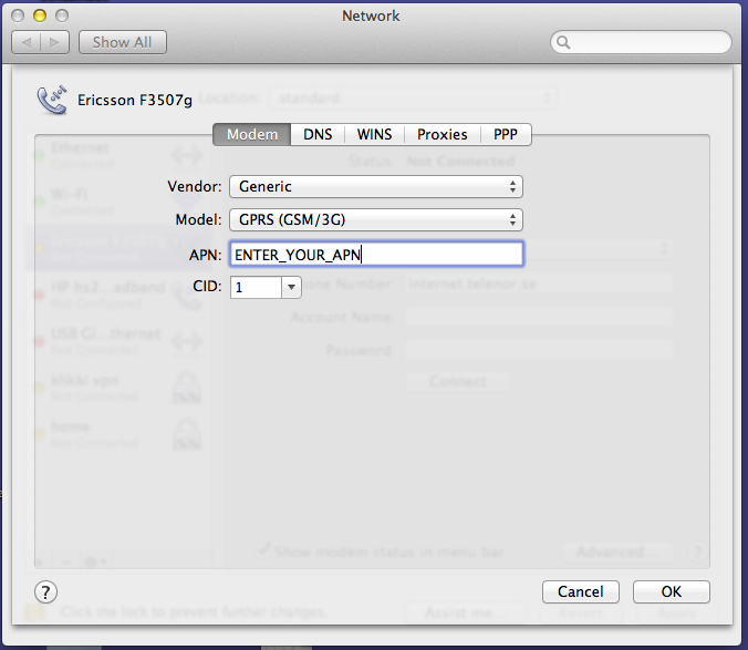

Administrators Leon Posted September 9, 2013 Administrators Share Posted September 9, 2013 Having access to the internet is for most of us alfa-omega, its become a part of our daily day.This is where mobile internet / 3g comes into play - today we'll have a look at the mini-pcie Ericsson f3507g card, this card is also known as Dell Wireless 5530.Requirements: A laptop that is prepared for WWAN (eg. sim card place) The card above This modem script: mobile-broadband.zip Steps to success: Before the below steps, make sure that you have a working simcard without pin code and the f3507g inserted correctly Download the modem script from above Extract the model script to /Library/Modem Scripts/ Open Network in System Preferences Select the WWAN card in the left and click Advanced Now we need to make sure that we are using the right modem script, ajust your settings so it looks like this: ... For some cards it works better to use "generic" and 3g.. like this .. NOTICE 1: You need to make sure that you are using the correct APN. Once you have ajusted it, click OK - you will now be returned to the Network screen - add a check in "Show modem status in menu bar" and finally click Apply.Thats it, you should be ready to connect - please post any questions / issues.//Leon Link to comment Share on other sites More sharing options...

sebdel Posted September 27, 2015 Share Posted September 27, 2015 Hi there, I know this is an old post, buy I just got my dell 5530 wwan card working in Yosemite, if anyone is still interested in using this 3g card (it's all 4g now) I installed the card in a thinkpad x220 tablet, in network settings 3 things showed up: Dell Wireless 5530 HSPA mobile Dell Wireless 5530 HSPA mobile 2 PCI serial adapter I used the modem script file, in advance modem settings selected "other" and " dell mobile broadband" just like the picture in the first post, then connected any of the two dell wireless 5530 (the pci serial adapter doesn't connect) using my APN as phone number and user/password blank. Works like a charm. 1 Link to comment Share on other sites More sharing options...
potatohead Posted February 17, 2017 Share Posted February 17, 2017 I can confirm the script by Leon in post #1 still works in El Capitan, and most probably Sierra. However, it has to be in USB modem mode using 'Dialup' and APN as the number to dial-up (the first picture; but with error correction and compression unchecked). It will also connect in WWAN mode too (if CellPhoneHelper.kext has been patched for OS X to recognize the card as WWAN), but because there is no option to key in APN, Safari reports there is no network. I have a hard time getting my Dell 5530 card to work, either as USB modem or WWAN card using 'Generic' and '3G', the script works wonder, many thanks. Link to comment Share on other sites More sharing options...
