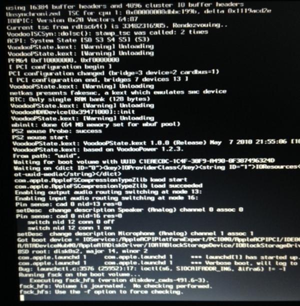

cpierce Posted May 13, 2014 Author Share Posted May 13, 2014 Thank you very much. I actually just tried -x for safe mode. The progress bar went about 25% and stopped. So I then tried -v. The last thing showing was about executing fsck. I got " volume is journaled so no checking performed" then " use -f option to force checking". I took a picture and will try to post it. I tried the -f but just got the spinning wheel again. I will try the -s option as well. If I can't get it figured out, I will go the MyHack usb route since I don't have it installed on my partition. The re-install option makes me nervous. I have a complete disk image that I can restore, but it is about 6 months old. Link to comment Share on other sites More sharing options...
Administrators Hervé Posted May 13, 2014 Administrators Share Posted May 13, 2014 You would normally expect stuff like Network drivers, DSMOS, etc after that. If you're getting stuck on a disk verification, maybe you ought to get it checked out. If you can, try and boot off a myHack USB installer, get to the main installation screen and go to Disk Utility to perform a HDD check and possible repair. It's not good that you can't even boot in safe mode. I also notice your D620 is reporting issues with VoodooPState. Any idea why? I attach a copy of a kernel log, having booted ML on my D620 GMA950. D620_kernel_log.rtfFetching info... Link to comment Share on other sites More sharing options...
