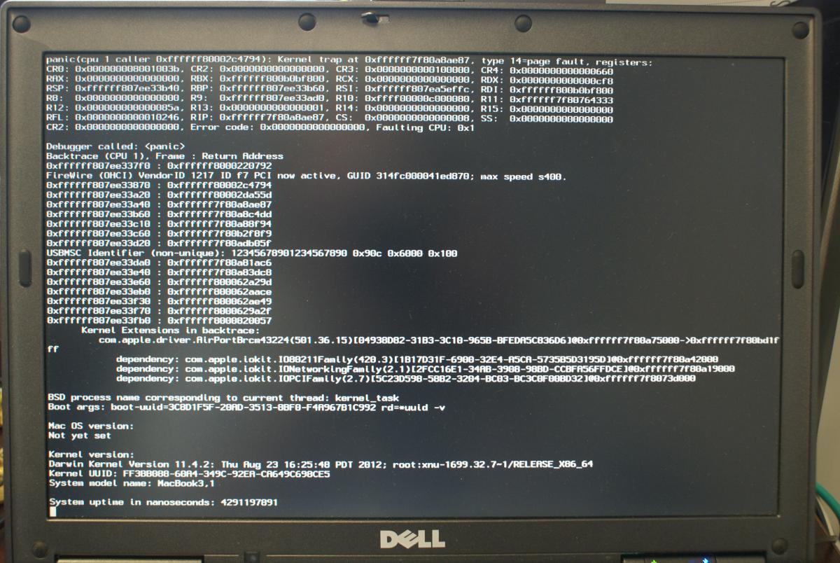

Basilio Posted August 22, 2014 Share Posted August 22, 2014 Then report back please. I made another usb stick via myHack, then put D630 Extra folder via myHack, then put AppleACPIPlatform.kext file in to /Extra/Extensions via Finder, then ran myFix (quick) via myHack. At the final i got a kernel panic on my D630. What's the next? Link to comment Share on other sites More sharing options...
Administrators Hervé Posted August 22, 2014 Administrators Share Posted August 22, 2014 Which exact version of Lion are you installing and what kind of wireless card do you have? If Intel, remove it or disable it in BIOS; it'll need replacement since unsupported. Link to comment Share on other sites More sharing options...
Basilio Posted August 22, 2014 Share Posted August 22, 2014 I try to install Mac OS X Lion 10.7.5 (11G63) [Multi/Rus].My D630 have Intel® PRO/Wireless 3945ABG card. I disable wi-fi card in BIOS and instalation process starts without kernel panic!My HDD is also visible now! Thanks a lot! You just a magician! p.s. Which wi-fi card i have to install in my D630 for best capability with OS X Lion? Link to comment Share on other sites More sharing options...
