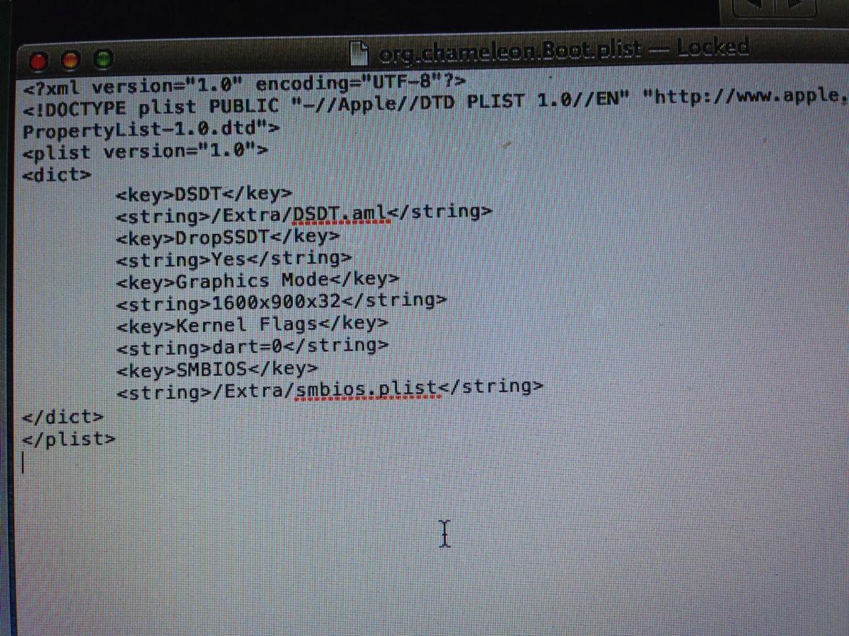

beseda Posted November 14, 2014 Share Posted November 14, 2014 Could be a DSDT issue. Do you have same CPU as the OP? Try same boot flags but with different FB value DSDT=0 nv_disable=1 GraphicsEnabler=Yes IntelCapriFB=4 dart=0 -v -f yes ok, thanks! Link to comment Share on other sites More sharing options...

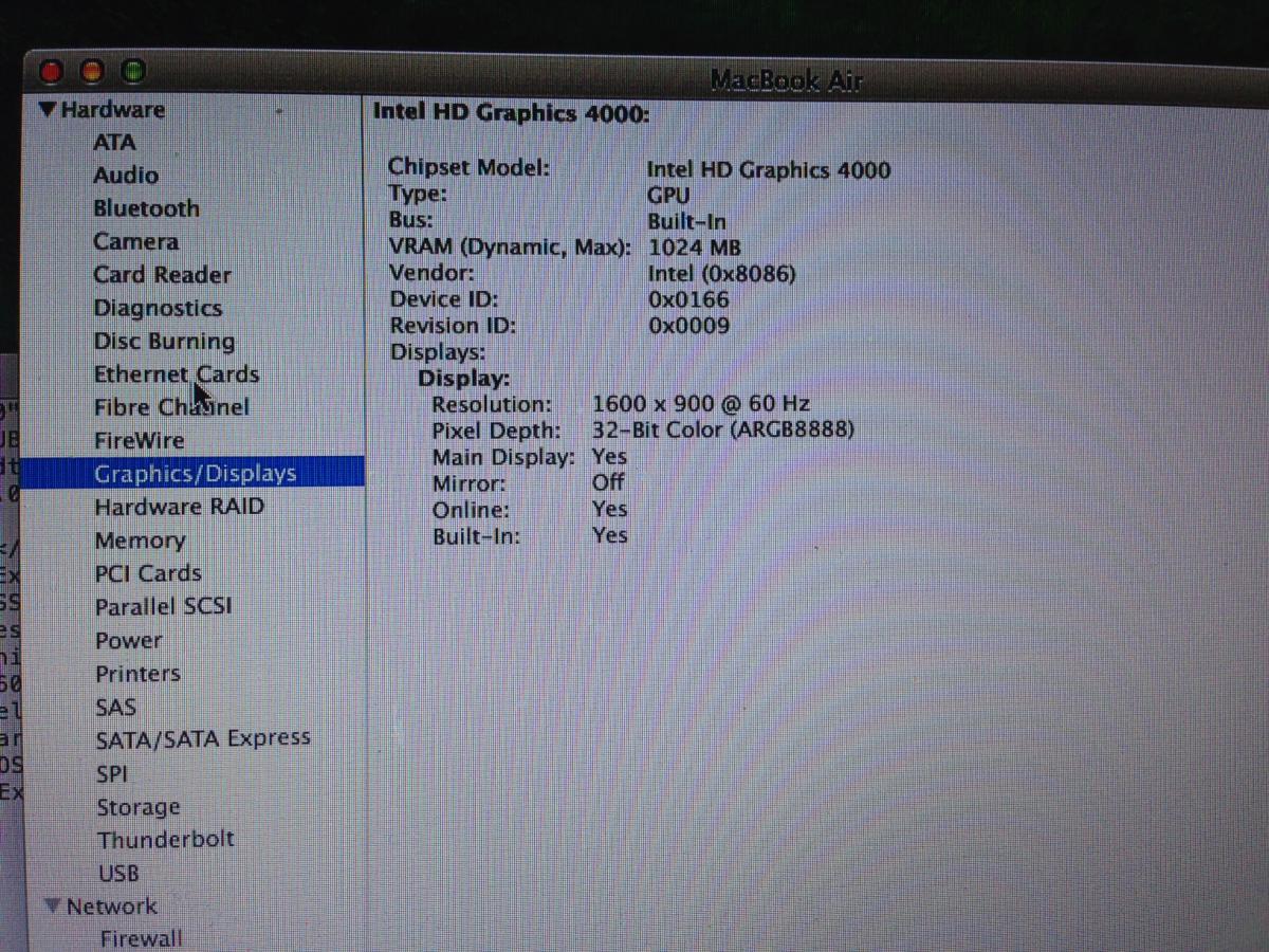

beseda Posted November 14, 2014 Share Posted November 14, 2014 USB will work with the patched DSDT. Right now, we're trying to figure out the correct value to get full QE/CI for your display. Then I could repatch your DSDT. Have you try the different value? from 0 to 11 Looks like it works with values 4 and 9. Tried feom 0 to 11. Display from NVIDIA and Video is IntelHD4000 Link to comment Share on other sites More sharing options...

beseda Posted November 15, 2014 Share Posted November 15, 2014 I seem to have the same issue with my system with nvidia/HD 4000. Booting with -f fixes it. I booted with -f and UseKernelCache=No flags. Still the same freezing message What else keys do I need to use? Link to comment Share on other sites More sharing options...
