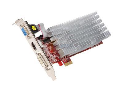

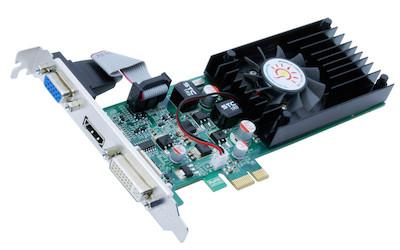

Administrators Hervé Posted October 26, 2014 Administrators Share Posted October 26, 2014 Sounds like Snow Leopard will be your best possibility on this 10yr old server due to legacy single-core Irwindale CPUs. Vanilla kernels will not be supported, only legacy versions like Nawcom's. You'd need early dual-core Xeon CPUs for Lion and later, but it does not look like they made it on the PowerEdge 1800. Have a look at my Precision 670 guide, you can use the provided SL pack to build your own. Start without a DSDT of course, don't use the Precision 670's. The embedded ATI Radeon chip will be extremely low-spec'ed (embedded graphics always are on servers) and is probably not supported at all under Mac OS X... Not the greatest machine for Hackintoshing in that case to be honest, maybe just as a Snow Leopard server. It seems the server has two PCIe x8 physical slots, one rated at x8, the other at x4. As such, you can't physically plug a x16 graphics card, unless you dremmel out the end of a slot but it looks like there's a heatsink in the path... Your could look for a PCIe x4/x8 graphics card supported by SL, if that exists (it's a big if)! I know the nVidia GeForce G210 and 8400GS existed in PCIe x1 format so you could envisage that as PCIe x1 cards fit and work into in PCIe x4/x8 slots. Radeon have some too, like the HD 4350. Those are all supported in SL. Otherwise, it's probably not worth the hassle: it's old, big, probably noisy and quite power-hungry though it'll certainly replace the heater in your room (Irwindale are 110W TDP... each)! My Precision 670 does. Link to comment Share on other sites More sharing options...
