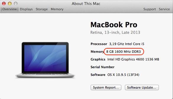

Administrators Hervé Posted February 28, 2015 Administrators Share Posted February 28, 2015 Technically, you are absolutely correct in the sense that PC3-12800 does indeed operate at a clock rate/bandwidth of 800MHz just like PC2-6400 (DDR2-800) operates at 400MHz or PC2-5300 (DDR2-667) operates at 333MHz. However, that is not how DDR RAM is dubbed in "marketing" terms. PC3-12800 = DDR3-1600 and in the SMBIOS context this is meant to be reflected as 1600 "MT/s", even though OS X uses the term "MHz". You may consider this artificial/incorrect doubling of memory speed but DDR means Double Data Rate and a confusion between MT/s and MHz (you may call it an abuse of language) has just generally settled in... http://en.wikipedia.org/wiki/DDR2_SDRAM http://en.wikipedia.org/wiki/DDR3_SDRAM Even respectable distributors like Crucial refer to speed in MHz rather than MT/s most of the time... http://www.crucial.com/usa/en/latitude-d630/CT2344599 http://www.crucial.com/usa/en/latitude-e6440/CT4972439 Anyway, any Apple Mac or Hackintosh with XX Go of DDRz-YYY RAM will/should report "XX GB YYY MHz DDRz" in "About This Mac". YYY is what the SMBIOS memory speed field will address. For instance, my Dell E6440 has 8Go of DDR3-1600 RAM in the form of 2 x PC3L-12800S SODIMMs. OS X reports RAM as follows: Link to comment Share on other sites More sharing options...
