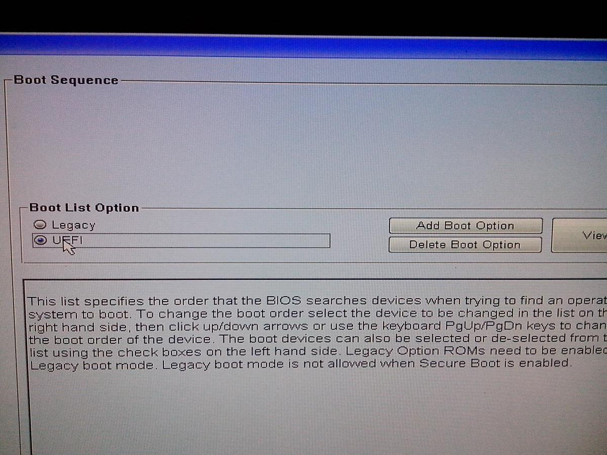

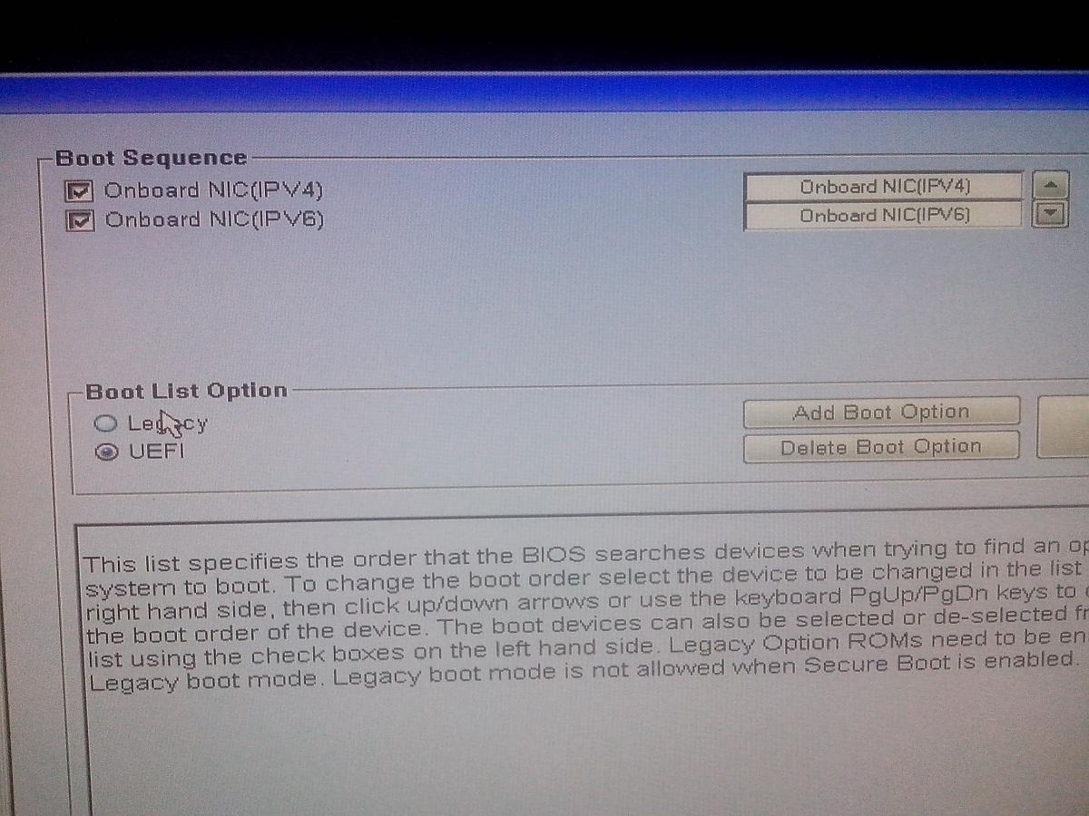

Moderators Jake Lo Posted October 15, 2015 Moderators Share Posted October 15, 2015 Are you using Clover or Chameleon? Seeing you set UEFI, I assume Clover. Using Clover Configurator version 4.24, open the Config.plist in /EFI/Clover. Navigate on the left side to Kernel and Kext Patches. Enable Kernel PM and Asus AICPUPM. But if I'm wrong and you are using Chameleon, then you'll need to patch the Kernel to prevent automatic reboot. Here's a collection of patched Haswell Kernels by Hervé. Select the one that correspond to the version of OS X you're installing. Place it in /System/Library/Kernels of the USB Installer. For DSDT and kexts to use, you can find them here. 1 Link to comment Share on other sites More sharing options...

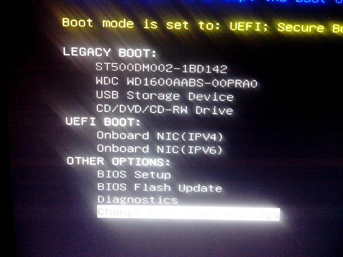

mostafa7bedo Posted October 15, 2015 Author Share Posted October 15, 2015 Thanx Jake Lo.. I tried what you said... even Haswell Kernels but id did not work... I'm using Chameleon on an Yosemite dmg not original from mac its called Yosemite-Zone.dmg--- i got an idea to update bios from dell ... i found it's not rebooting any more... but after i got desk utility and format partition just one partition not the entire hard drive.. as mac os x journaled.... it failed the installation it gives me this log file I don't know is it the dmg or because I did not format the whole hard drive (160 giga ...one partion 29 giga... the second partition has the rest size).. i format only the 29 giga.... or i need an original dmg i don't have any experience of installing hakintosh before thanx for reply Installer Log 15-Oct-2015.txt Link to comment Share on other sites More sharing options...
Moderators Jake Lo Posted October 15, 2015 Moderators Share Posted October 15, 2015 AFAIK Chameleon does not support UEFI, change the bios settings back to Legacy. You could follow my guide here if you have a dmg from AppleStore. Link to comment Share on other sites More sharing options...

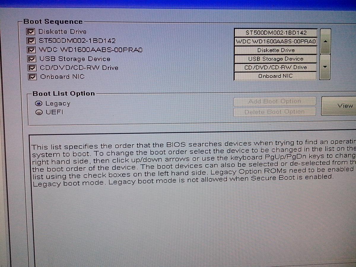

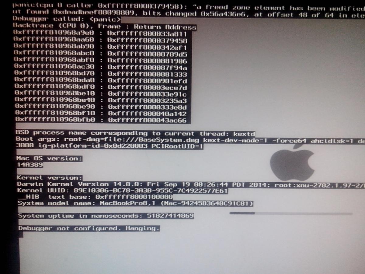

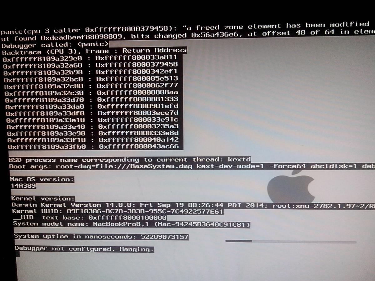

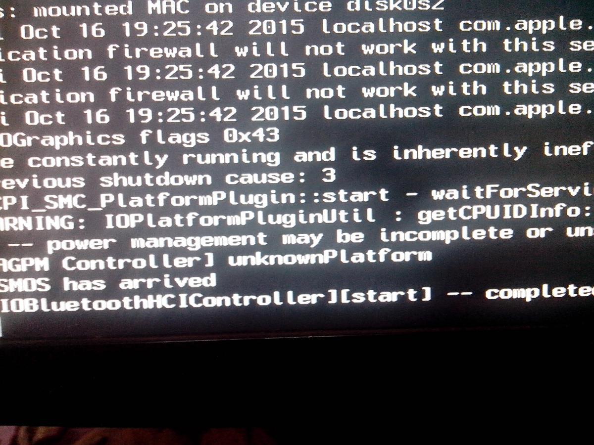

mostafa7bedo Posted October 21, 2015 Author Share Posted October 21, 2015 I made a flash drive contain Yousemite 10.10 original one by using chameleon (by my i mac at my work)... using Haswell Kernels dell 9020 but I got this images....I was tried to keep my ram 4giga only but it didn't work>>>> please waiting for any help.... Thanks I'm using legacy.... vt is off.... Link to comment Share on other sites More sharing options...
Moderators Jake Lo Posted October 21, 2015 Moderators Share Posted October 21, 2015 try booting with these switches -v -f -no-zp Link to comment Share on other sites More sharing options...
mostafa7bedo Posted October 22, 2015 Author Share Posted October 22, 2015 I tried but stile the same problem Link to comment Share on other sites More sharing options...

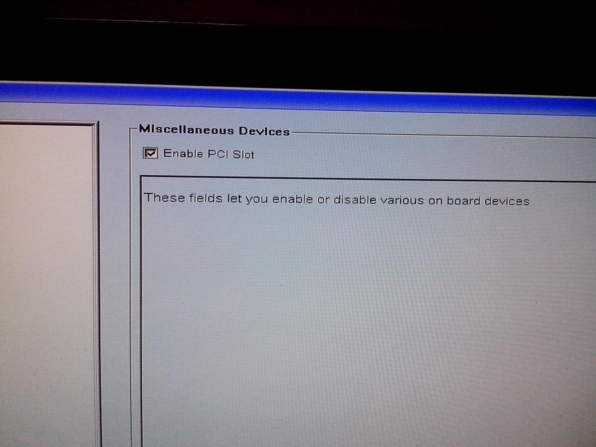

Moderators Jake Lo Posted October 22, 2015 Moderators Share Posted October 22, 2015 Did you place the Kexts and DSDT into the right directory? You need to remove the PCIe card if it has one. Only use the onboard video card and must use DisplayPort connection. Boot with -v -f -no-zp GraphicsEnabler=Yes IntelAzulFB=10 If you want to use the Sapphire HD 6450 card, try this bootflag -v -f -no-zp GraphicsEnabler=Yes AtiConfig=Pithecia Link to comment Share on other sites More sharing options...
mostafa7bedo Posted October 28, 2015 Author Share Posted October 28, 2015 I used -v -f -no-zp GraphicsEnabler=Yes AtiConfig=Pithecia for HD 6450 card but it didn't work.. So I'm going to use -v -f -no-zp GraphicsEnabler=Yes IntelAzulFB=10 onboard video card using DisplayPort connection.. Thanks Link to comment Share on other sites More sharing options...
