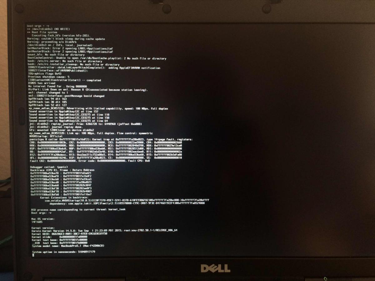

Hi,
I've installed and updated Yosemite (10.10.5 (14F1605)) on my M4300. Worsk like a charm until I installed nvidia web driver.
Now I have a panic in NVDAStartup.
I tried nv_disable=1, nvda-drv=0, still got a panic.
It looks like people usually got panic after NVDAStartup and can still boot with nv_disable=0, so I couldn't find much help. Anyone got an idea ?
thanks,
Jief
Try and boot in safe mode and without graphics enabler (-x GraphicsEnabler=No). If you reach the desktop, set OS X back to default OS drivers and remove the nVidia web driver. M4300 works fine with OS X default drivers.
