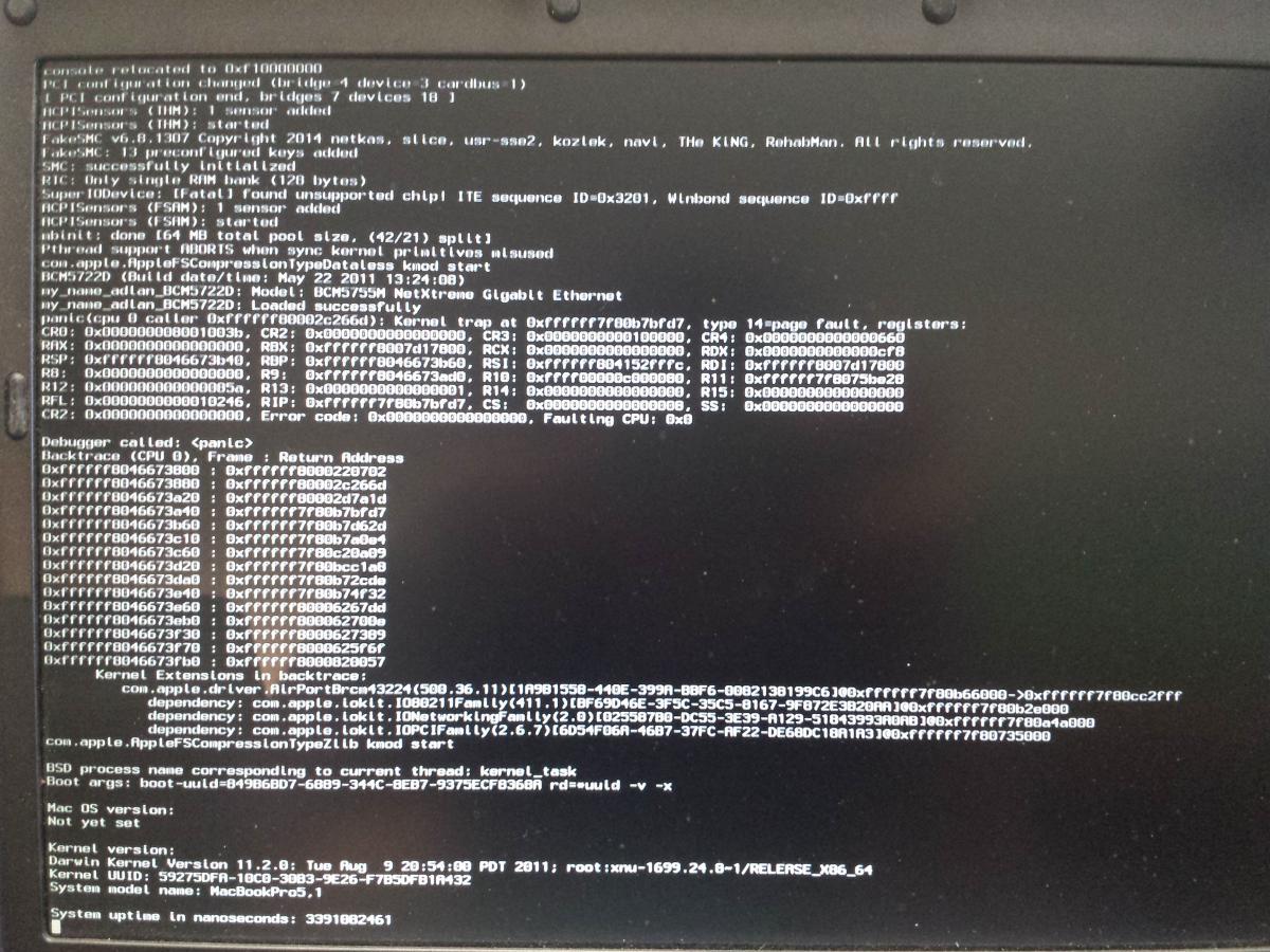

8) Attempted to boot to the USB stick. The initial screen where you can type in boot options loads, but I have not yet been able to get as far as the graphical part of the installer (where you can do disk formatting, etc) due to kernel panic (see attached image). I have tried booting using -x, which I believe is supposed to be "safe mode", but it didn't help.
I took a quick look around the myHack page and these forums searching for terms I saw on the screen, but I didn't find any exact matches and I don't have enough experience to be able to interpret if the fixes that worked for other people would be applicable to my situation. I'm also not quite sure what the problem is - the stack trace says something about "AirPort" so I tried the install again with the wifi switch turned off, but that did not seem to change anything. Higher up, there is also a mention of "Super IODevice: [Fatal] found unsupported chip", not sure how to interpret that.

You have a KP because your D830 is fitted with an Intel wireless card (no Intel card is supported, it has to be replaced) whilst the DSDT is configured for a Broadcom-based DW1395:
               Device (ARPT)
                    Name (_ADR, Zero)  // _ADR: Address
                    Name (_PRW, Package (0x02)  // _PRW: Power Resources for Wake
                        0x09,
                        0x04
                    OperationRegion (SVID, PCI_Config, Zero, 0xF0)
                    Field (SVID, DWordAcc, NoLock, Preserve)
                        Offset (0x2C),
                        SUBS,   32
                    Method (_DSM, 4, NotSerialized)  // _DSM: Device-Specific Method
                        Store (Package (0x10)
                                "device-id",
                                Buffer (0x04)
                                     0x11, 0x43, 0x00, 0x00
                                "name",
                                Buffer (0x0D)
                                    "pci14e4,4311"
                                "AAPL,slot-name",
                                Buffer (0x08)
                                    "AirPort"
                                "subsystem-vendor-id",
                                Buffer (0x04)
                                     0x6B, 0x10, 0x00, 0x00
                                "subsystem-id",
                                Buffer (0x04)
                                     0x88, 0x00, 0x00, 0x00
                                "model",
                                Buffer (0x13)
                                    "Dell Wireless 1395"
                                "device_type",
                                Buffer (0x08)
                                    "Airport"
                                "built-in",
                                Buffer (One)
                                     0x00
                            }, Local0)
                        Return (Local0)
Either disable your wireless card in BIOS (which you really should update to A15 version) or use the revised DSDT below where ARPT device bears no _DSM method any more.

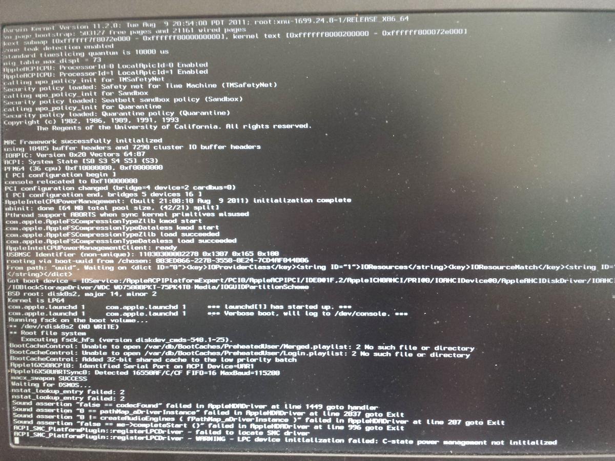

You do not boot from hard disc because myHack did not install Chameleon on it. Boot your fresh Lion installation through the USB key (interrupt bootstrap with any key or F8, then select your Lion HDD partition) and re-run myHack to install Chameleon on your HDD Lion partition. Failing that, download a Chameleon version such as r2395/r2401 off InsanelyMac (these older version are 100% safe on D Series)

Using the usb stick, I booted the hard drive for the first time into safe mode (accidentally - that's what I had to do to get the usb installer to boot). The system came up and I went through the account creation process. Once that completed and I logged in, I tried to run myHack. It told me that it could not run in safe mode, and that if the system can not boot normally to try it from the usb installer. I rebooted the system using the usb stick and booted the hard drive again, but without using safe mode. It hung while booting - the last two lines of output are
ACPI_SMC_PlatformPlugin::registerLPCDriver - failed to locate SMC driver
ACPI_SMC_PlatformPlugin::registerLPCDriver - WARNING - LPC device initialization failed: C-state power management not initialized.
I rebooted to the usb installer and ran myhack to install chameleon on the HDD from the utilities menu. Now I can boot to the hard drive directly, but only using safe mode. Attempting to boot normally causes the system to hang the same way I saw earlier. Ive included a screen shot.
