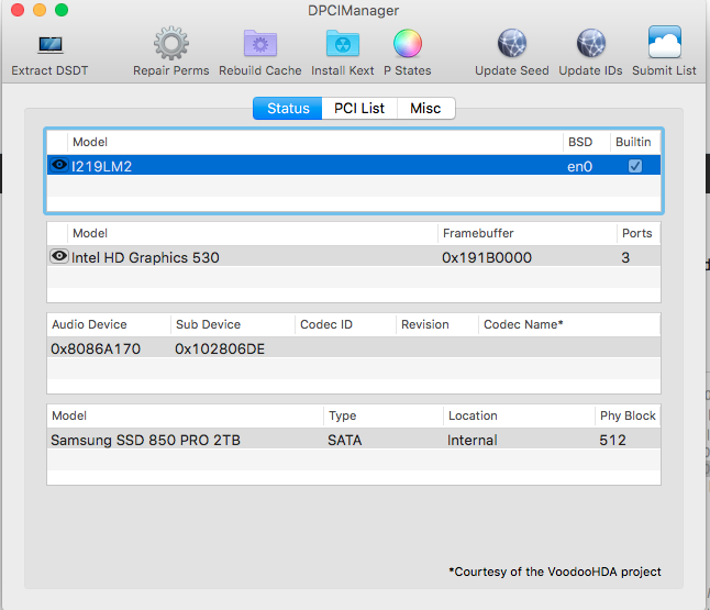

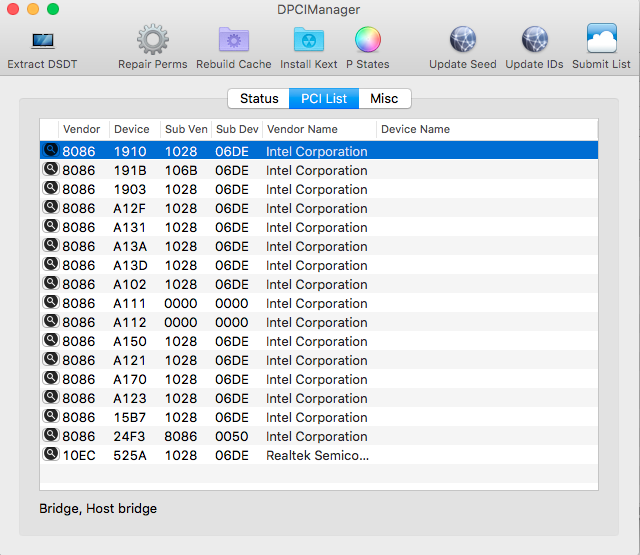

Moderators Jake Lo Posted November 21, 2016 Moderators Share Posted November 21, 2016 Launch DPCIManager. Attach screenshot of Status and PCI List. Use Alt+Shift+4, hit spacebar and then left mouse click to capture. Expand the page so that all info is capture. Link to comment Share on other sites More sharing options...
mdub Posted November 21, 2016 Author Share Posted November 21, 2016 screenshots- Link to comment Share on other sites More sharing options...
Moderators Jake Lo Posted November 22, 2016 Moderators Share Posted November 22, 2016 What's the system specs? CPU? Audio Codec? Does it have discrete card? According to the screenshot above you have HD 530. Link to comment Share on other sites More sharing options...
