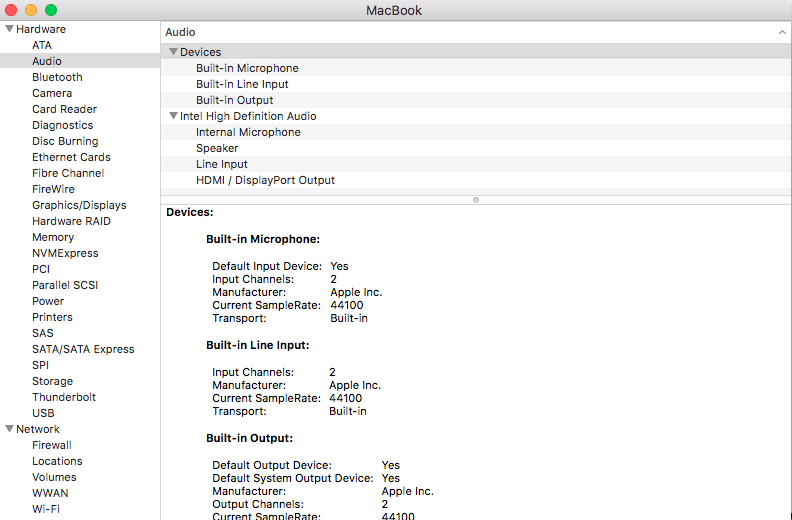

Tomba81 Posted January 8, 2017 Author Share Posted January 8, 2017 Got to investigate dsdt closely look HDMI audio... defently need some patch?! 1 Link to comment Share on other sites More sharing options...

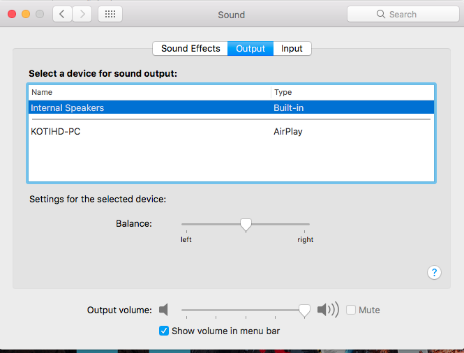

Tomba81 Posted January 9, 2017 Author Share Posted January 9, 2017 Sory, i was too fast, problem still there Strange, when I leaved laptop to sleep about 5min. and started, a problem still continue! Possibly i started my laptop to quickly from sleep mode at the first time?? after installed codec commander... Maybe something to do with deep sleep?? I try your proposal! Heres my config.plist config.plist.zip Link to comment Share on other sites More sharing options...
Tomba81 Posted January 9, 2017 Author Share Posted January 9, 2017 Finally, i think i found a solution for this sleep mode issue!? When I put it to sleep mode, and fire up again i need to make 'fast double press' power button, so that the sound stays on! If i press power button only once, sound is missing! a strange problem have to say... It looks like this little trick works so far!? I tried you patch. No go! <dict><key>Comment</key><string>HD 520 HDMI #1</string><key>Disabled</key><false/><key>Find</key><data>AQUJAAAEAAA=</data><key>Name</key><string>AppleIntelSKLGraphicsFramebuffer</string><key>Replace</key><data>AQUJAAAIAAA=</data> </dict> HDMI audio still missing... Thanks anyway! Link to comment Share on other sites More sharing options...

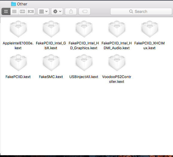

Moderators Jake Lo Posted January 9, 2017 Moderators Share Posted January 9, 2017 Try adding FakePCIID and FakePCIID_Intel_HD_Graphics Link to comment Share on other sites More sharing options...
Tomba81 Posted January 10, 2017 Author Share Posted January 10, 2017 Hi Jake Lo, All ready have necessary kext inside Efi/C/K/O. If you mean that? Thanks Link to comment Share on other sites More sharing options...
