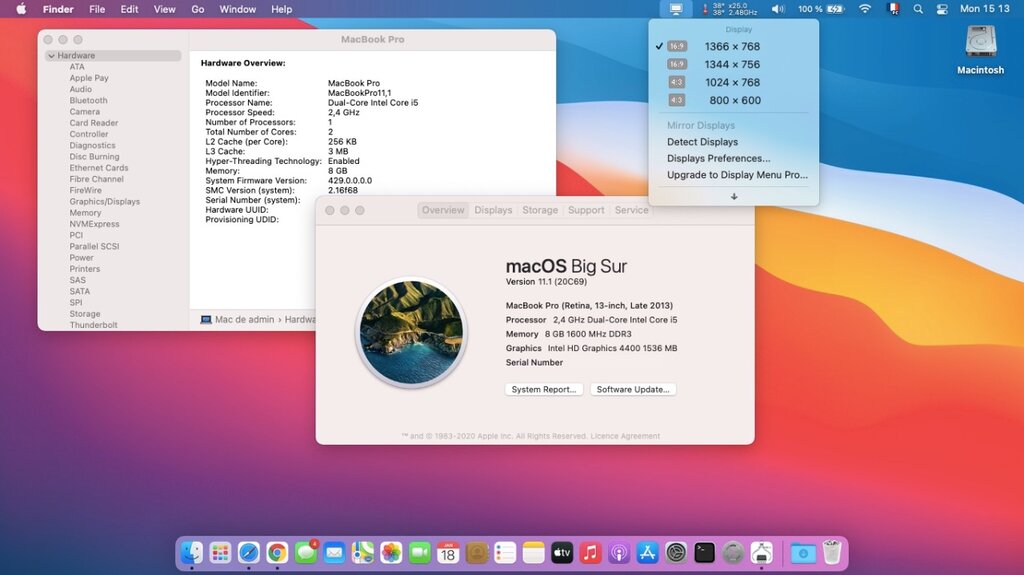

Target macOS release:
  • Big Sur 11.x
This is an OpenCore-based installation (on a SATA-III 6Gb/s SSD) using the standard vanilla method detailed below:
Sat_R50-B-116_i5-4210U_BigSur_11.1(20C69).jpg   Sat_R50-B-116_BS_SpeedStep.jpg
Working:
  • full graphics acceleration on Intel HD4400 graphics (with Lilu v1.5.0 v1.6.0 + WEG v1.4.6 v1.5.8 + usual Azul FB properties injection)
  • multi-display on VGA (OOB) + HDMI (with injected connector patch)
  • brightness control with Fn-Ins/Fn-PgDn (with Dortania's SSDT-PNLF); keys remapping required here
  • audio, including combo jack microphone input/headphones output (with VoodooHDA v2.9.2 + AppleHDADisabler); manual output selection required between speakers and headphones. I was only able to get audio with AppleALC (layout 13) if I booted with Clover.
  • HDMI audio (with ACPI renaming of B0D3 to HDAU)
  • GigEthernet LAN (with Mieze's RealtekRTL8111 v2.4.0d6)
  • wireless with any compatible card
  • integrated webcam (OOB)
  • Realtek USB-internal SD Card reader (with Firewolf's RealtekCardReader v0.9.6)
  • full CPU power management 0.8->1.7GHz, including Turbo boost 1.8->2.7GHz (with Dortania's SSDT-PLUG.aml)
  • sleep & wake (with Hackintool's SSDT-UIAC):
    • sleep with Battery PrefPane settings, Apple menu, PWR button but not through lid closing
    • wake with PWR button, keyboard key, mouse/trackpad, lid opening, AC plugging
  • partial battery management (with Rehabman's ACPIBatteryManager v1.90.1); no auto-detection of AC plugging/unplugging (except after sleep/wake) but battery charge % Ok
  • keyboard & basic TrackPad functionalities (with Rehabman's VoodooPS2Controller v1.9.2)
  • all USB ports
Not working:
  • AC charger plugging/unplugging; proper status only reflected at startup or after wake
  • Bluetooth; not seen/detected due to likely USB-related issue; in fact, Bluetooth no longer appears/works in Windows after having booted macOS with OC
GeekBench v4.4.x (64bit) results:

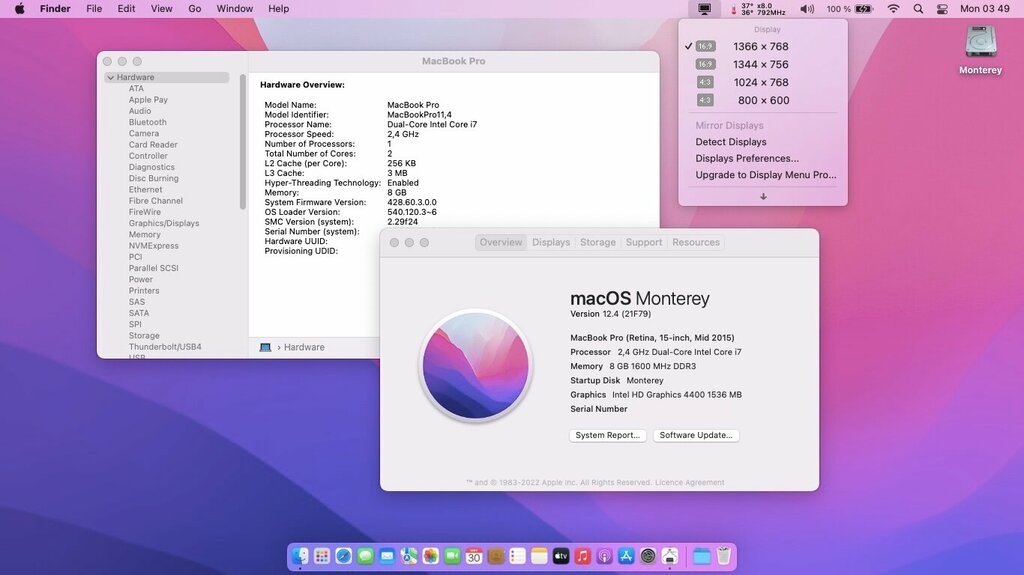

  • Monterey 12.x
Working:
  • full graphics acceleration on Intel HD4400 graphics (with Lilu v1.6.0 + WEG v1.5.8 + usual Azul FB properties injection)
  • GigEthernet LAN (with Mieze's RealtekRTL8111 v2.4.2)
  • wireless with any compatible card (here I switched from Broadcom-based DW1820A to Intel 8260NGW + itlwm driver)
  • all USB ports
Not working:
