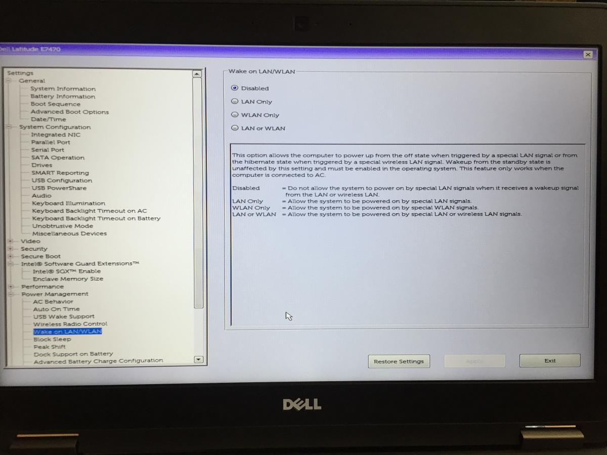

spikar Posted December 6, 2017 Author Share Posted December 6, 2017 What settings should be under Wireless Radio Control and Wake on LAN/WLAN in Bios? Link to comment Share on other sites More sharing options...

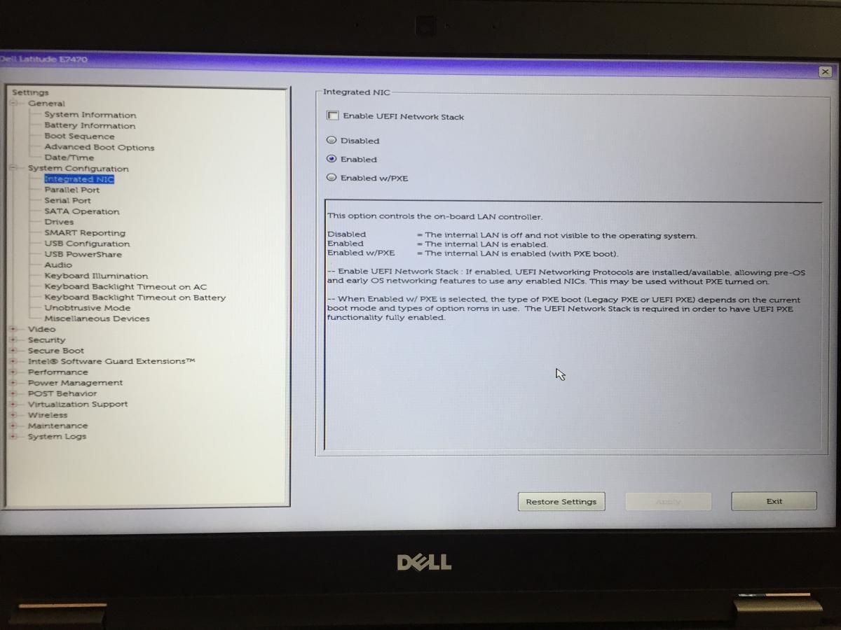

Moderators Jake Lo Posted December 6, 2017 Moderators Share Posted December 6, 2017 Neither. Go to System Configuration/Integrated NIC. Select Enabled. Disable Wake On LAN/WLAN, help with sleep issue Link to comment Share on other sites More sharing options...
spikar Posted December 6, 2017 Author Share Posted December 6, 2017 Cheers. Have done so. Still no luck. Wonder what it could be... Link to comment Share on other sites More sharing options...

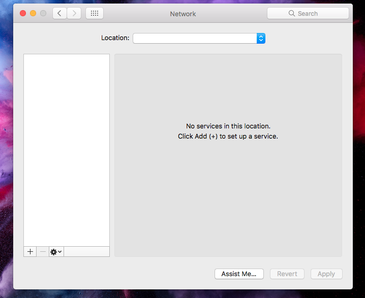

Moderators Jake Lo Posted December 6, 2017 Moderators Share Posted December 6, 2017 Copy the SystemConfiguration folder to the Desktop as a backup and then delete the folder in Preferences. Reboot, it should recreate a new folder. Also in Network Location, can you select the drop down and select Automatic? Link to comment Share on other sites More sharing options...

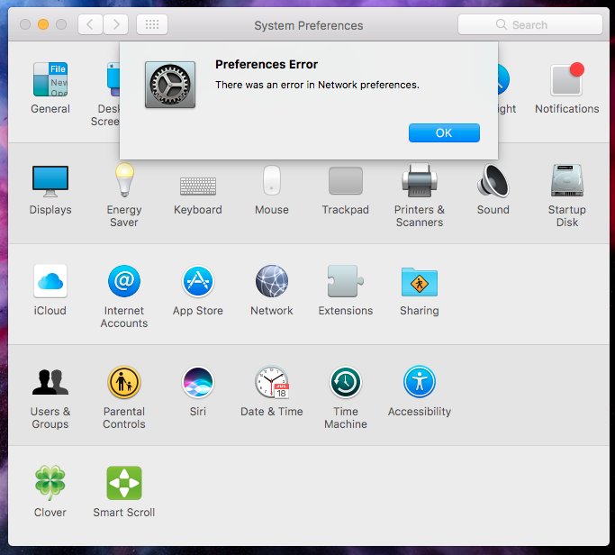

spikar Posted December 6, 2017 Author Share Posted December 6, 2017 Ok Thanks. Just tried. It created a new 'SystemConfiguration' folder with nothing in there. Still giving me the same error when trying to 'Create a new service' In location dropdown - it only has 'Edit Locations' Link to comment Share on other sites More sharing options...
