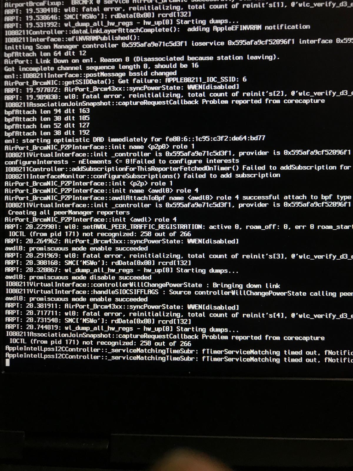

unikat74 Posted March 3, 2018 Author Share Posted March 3, 2018 After uploading and performing these operations sudo chown -Rf 0:0 /L*/E* sudo touch -f /L*/E* sudo chmod -Rf 755 /S*/L*/E* sudo chown -Rf 0:0 /S*/L*/E* sudo touch -f /S*/L*/E* sudo kextcache -Boot -U / I stop the start of the system in the picture. Removal of ApleHDA kexts from L / E system starts Link to comment Share on other sites More sharing options...
Moderators Jake Lo Posted March 3, 2018 Moderators Share Posted March 3, 2018 you left out this sudo chmod -Rf 755 /L*/E* Try booting in Safemode and fix the permission again Link to comment Share on other sites More sharing options...
unikat74 Posted March 3, 2018 Author Share Posted March 3, 2018 Notice has change MacBook-Pro-unikat74:~ unikat74$ sudo chmod -Rf 755 /L*/E* MacBook-Pro-unikat74:~ unikat74$ sudo chown -Rf 0:0 /L*/E* MacBook-Pro-unikat74:~ unikat74$ sudo touch -f /L*/E* MacBook-Pro-unikat74:~ unikat74$ sudo chmod -Rf 755 /S*/L*/E* MacBook-Pro-unikat74:~ unikat74$ sudo chown -Rf 0:0 /S*/L*/E* MacBook-Pro-unikat74:~ unikat74$ sudo touch -f /S*/L*/E* MacBook-Pro-unikat74:~ unikat74$ sudo kextcache -Boot -U / rebuilding //System/Library/PrelinkedKernels/prelinkedkernel Kext with invalid signatured (-67062) allowed: <OSKext 0x7fe1a33e7fc0 [0x7fff9f142980]> { URL = "AppleBacklightInjector.kext/ -- file:///Library/Extensions/", ID = "org.rehabman.injector.AppleBacklightInjector" } Kext with invalid signatured (-67062) allowed: <OSKext 0x7fe1a33cef10 [0x7fff9f142980]> { URL = "FakePCIID.kext/ -- file:///Library/Extensions/", ID = "org.rehabman.driver.FakePCIID" } Kext with invalid signatured (-67062) allowed: <OSKext 0x7fe1a33da2c0 [0x7fff9f142980]> { URL = "FakePCIID_Broadcom_WiFi.kext/ -- file:///Library/Extensions/", ID = "org.rehabman.injector.FakePCIID-Broadcom-WiFi" } Kext with invalid signatured (-67062) allowed: <OSKext 0x7fe1a33c4420 [0x7fff9f142980]> { URL = "FakePCIID_Intel_HDMI_Audio.kext/ -- file:///Library/Extensions/", ID = "org.rehabman.injector.FakePCIID-Intel-HDMI-Audio" } Kext with invalid signatured (-67062) allowed: <OSKext 0x7fe1a33a3d80 [0x7fff9f142980]> { URL = "CodecCommander.kext/ -- file:///Library/Extensions/", ID = "org.tw.CodecCommander" } kxld[com.apple.driver.AGDCBacklightControl]: The following symbols are unresolved for this kext: kxld[com.apple.driver.AGDCBacklightControl]: AppleBacklightParameterHandler::interpolatePanelTable(unsigned short const*, unsigned short, unsigned short, unsigned int, unsigned short*, unsigned short) kxld[com.apple.driver.AGDCBacklightControl]: AppleBacklightParameterHandler::loadScaledMobileBacklightTable(unsigned short, unsigned short**, unsigned short*) Link failed (error code 5). Prelink failed for com.apple.driver.AGDCBacklightControl; omitting from prelinked kernel. KernelCache ID: 11A1A2AD4B15418B9B639EE2A6745D4F kextcache updated critical boot files, requesting launchd reboot MacBook-Pro-unikat74:~ unikat74$ Link to comment Share on other sites More sharing options...
Moderators Jake Lo Posted March 3, 2018 Moderators Share Posted March 3, 2018 ??? Still no audio or can't boot? Link to comment Share on other sites More sharing options...

unikat74 Posted March 3, 2018 Author Share Posted March 3, 2018 Yes removal HDA kext from l/e boot normal but no audio Link to comment Share on other sites More sharing options...
unikat74 Posted March 3, 2018 Author Share Posted March 3, 2018 can't boot Link to comment Share on other sites More sharing options...
Moderators Jake Lo Posted March 3, 2018 Moderators Share Posted March 3, 2018 On 3/3/2018 at 7:44 PM, unikat74 said: Yes removal HDA kext from l/e boot normal but no audio here you say boot normal...so I'm confused. Can you boot back to OS X? Link to comment Share on other sites More sharing options...
unikat74 Posted March 3, 2018 Author Share Posted March 3, 2018 boot normal, I mean, up to the OS X login screen, Link to comment Share on other sites More sharing options...
