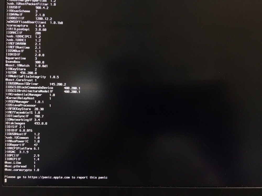

liemhatang Posted April 10, 2018 Share Posted April 10, 2018 Hi all. i update BIOS 1.17.5 -> 1.18.5 DVMT defaults. How to change it? see guild but hide: Thanks all. Link to comment Share on other sites More sharing options...
liemhatang Posted September 25, 2018 Author Share Posted September 25, 2018 hi Viking1304 re: what about for HD520. framebuffer patches: AAPL,ig-platform-id - 00001619 framebuffer-patch-enable - 01000000 (this is actually 00000001, but it needs to be in reverse order) - enable patch framebuffer-stolenmem - 00003001 (this is actually 01300000) - set framebuffer to 19MB framebuffer-fbmem - 00009000 (this is actually 00900000) - set cursor to 9MB Link to comment Share on other sites More sharing options...
viking1304 Posted September 25, 2018 Share Posted September 25, 2018 That looks good and should work for HD520. Use latest Lilu (1.2.7) and WhateverGreen (1.2.3). Remove FakePCIID _Intel_HD_Graphics, IntelGraphicsFixup, IntelGraphicsDVMTFixup and Shiki. Check Preliminary part of WhateverGreen framebuffer patching instructions and remove other patches mentioned there that you can remove yourself with Clover Configurator, but backup your config first. Link to comment Share on other sites More sharing options...
liemhatang Posted September 25, 2018 Author Share Posted September 25, 2018 top here. attach my config. kext delete akePCIID _Intel_HD_Graphics, IntelGraphicsFixup, IntelGraphicsDVMTFixup and Shiki config.plist.zip Link to comment Share on other sites More sharing options...
