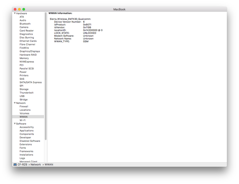

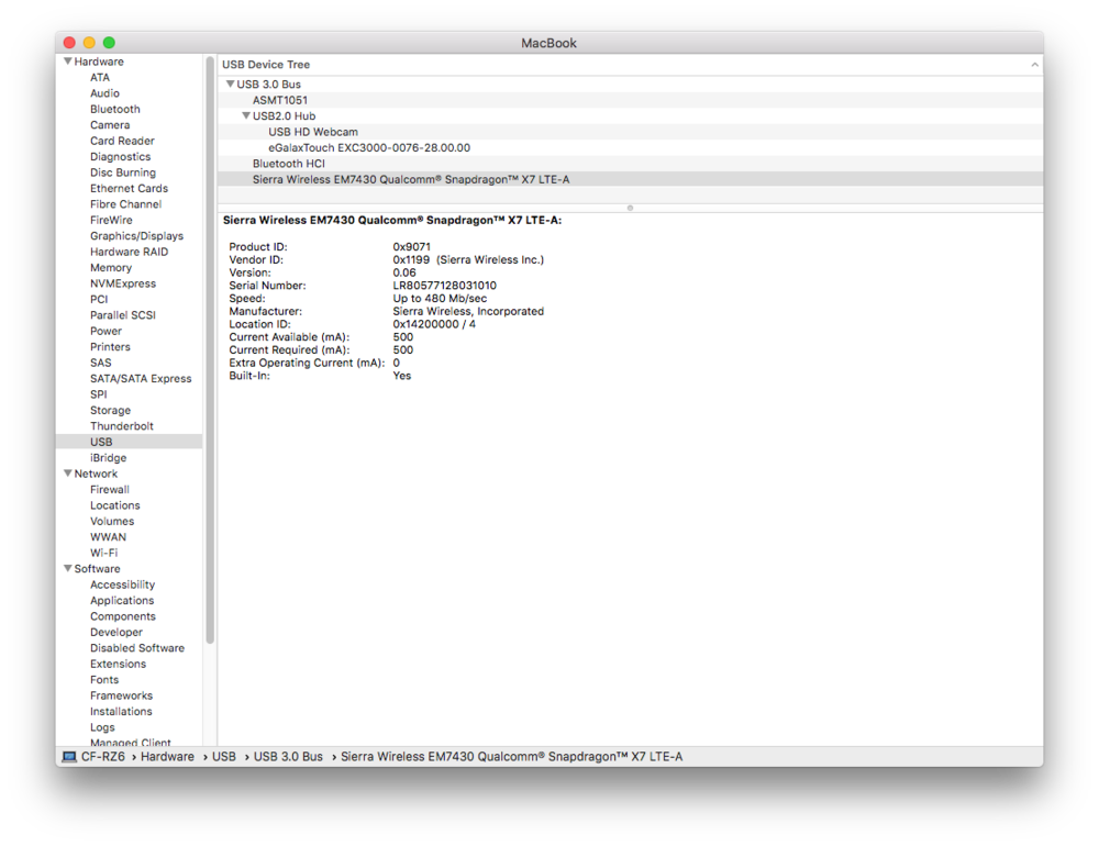

ccr4700 Posted May 4, 2018 Share Posted May 4, 2018 Hello. I'm trying to use Sierra Wireless EM7430 on Panasonic CF-RZ6 with High Sierra 10.13.4. The card is detected as USB device by default. And I use Legacy_Sierra_QMI_10.13.kext. Here is my Info.plist. Spoiler <?xml version="1.0" encoding="UTF-8"?> <!DOCTYPE plist PUBLIC "-//Apple//DTD PLIST 1.0//EN" "http://www.apple.com/DTDs/PropertyList-1.0.dtd"> <plist version="1.0"> <dict> <key>BuildMachineOSBuild</key> <string>16B2657</string> <key>CFBundleDevelopmentRegion</key> <string>English</string> <key>CFBundleIdentifier</key> <string>com.apple.driver.LegacySierraQMI</string> <key>CFBundleInfoDictionaryVersion</key> <string>6.0</string> <key>CFBundleName</key> <string>Legacy Sierra QMI</string> <key>CFBundlePackageType</key> <string>KEXT</string> <key>CFBundleShortVersionString</key> <string>1.4.0</string> <key>CFBundleSignature</key> <string>????</string> <key>CFBundleSupportedPlatforms</key> <array> <string>MacOSX</string> </array> <key>CFBundleVersion</key> <string>1.4.0</string> <key>IOKitPersonalities</key> <dict> <key>0x1199/0x9071 EM7430</key> <dict> <key>CFBundleIdentifier</key> <string>com.apple.driver.AppleUSBHostMergeProperties</string> <key>IOClass</key> <string>AppleUSBHostMergeProperties</string> <key>IOProviderClass</key> <string>IOUSBHostDevice</string> <key>IOProviderMergeProperties</key> <dict> <key>DeviceModemOverrides</key> <dict> <key>ConnectionPersonality</key> <string>Sierra GSM Personality</string> <key>ConnectionScript</key> <string>WWAN.ccl</string> <key>DeviceContextID</key> <string>1</string> <key>DeviceModel</key> <string>GSM</string> <key>DeviceVendor</key> <string>Sierra Wireless</string> </dict> <key>DevicePPPOverrides</key> <dict> <key>LCPMTU</key> <integer>1450</integer> </dict> <key>InfoCommands</key> <dict> <key>ATCommands</key> <dict> <key>DirectoryNumber</key> <string>+cnum</string> <key>IMEI</key> <string>+cgsn</string> <key>IMSI</key> <string>+cimi</string> <key>Manufacturer</key> <string>+cgmi</string> <key>Model</key> <string>+cgmm</string> <key>ModemSW</key> <string>+cgmr</string> <key>Serial#</key> <string>+gsn</string> </dict> <key>HiddenProperties</key> <dict> <key>CommandPortBaseName</key> <string>wwan</string> <key>ControlPortBaseName</key> <string>wwan</string> <key>DataPortBaseName</key> <string>wwan</string> <key>StatusType</key> <string>CellPhoneGSM</string> </dict> </dict> <key>Initializing</key> <true/> <key>InterfaceMapping</key> <dict> <key>0</key> <dict> <key>name</key> <string>wwanDM</string> </dict> <key>2</key> <dict> <key>name</key> <string>wwanGPS</string> </dict> <key>3</key> <dict> <key>name</key> <string>wwan</string> </dict> </dict> <key>WWAN</key> <true/> </dict> <key>bcdDevice</key> <integer>6</integer> <key>idProduct</key> <integer>36977</integer> <key>idVendor</key> <integer>4505</integer> </dict> </dict> <key>OSBundleLibraries</key> <dict> <key>com.apple.driver.AppleUSBHostMergeProperties</key> <string>1.0</string> <key>com.apple.iokit.IOUSBHostFamily</key> <string>1.0.1</string> <key>com.apple.kpi.iokit</key> <string>8.0</string> <key>com.apple.kpi.libkern</key> <string>9.0.0</string> </dict> <key>OSBundleRequired</key> <string>Root</string> </dict> </plist> With Legacy kext, the card is recognized as WWAN card, but Modem Software shows Unknown. Connect button is disabled in System Configuration so I can't use it. USBCOMP is 8 by default, and 14 is not supported in this card. swi_usbcomp.pl output was like below.https://zukota.com/sierra-wireless-em7455-how-to-enable-com-ports/ (It's EM7455 result, but EM7430 is Asia version of EM7455 so both are almost same card.) swi_usbcomp.pl requires MBIM to work, and USBCOMP should be 8 to use with Windows. So I avoid to use 6, use 8. It may be a problem the card is recognized under USB 3.0, but I can't change it by FakePCIID_XHCIMux.kext because this PC is Kaby Lake based that doesn't have EHCI. I attached IORegistryExplorer output. If EM7430 is not capable to use in High Sierra, I'll buy EM7330 instead. If it is not chip related problem, I want to know the solution. Any ideas? cf-rz6.ioreg Link to comment Share on other sites More sharing options...

ccr4700 Posted May 5, 2018 Author Share Posted May 5, 2018 Icon show this. When I click "Connect", this message appeared. Link to comment Share on other sites More sharing options...

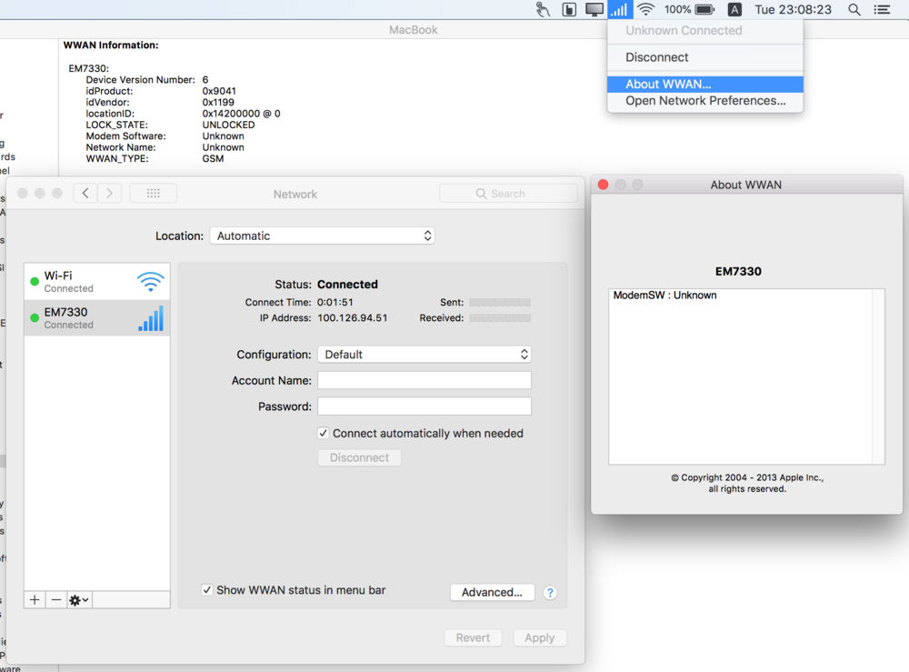

ccr4700 Posted May 15, 2018 Author Share Posted May 15, 2018 I bought EM7330 and it worked with USBCOMP=14. The Modem Software still shows Unknown but I can select connect button from menu. I only modified device id in Legacy_Sierra_QMI_10.13.kext from 36977(EM7440) to 36929(EM7330). No other changes. I don't know why EM7430 doesn't work but I still want to get it work because it has better specification than EM7330. Link to comment Share on other sites More sharing options...
