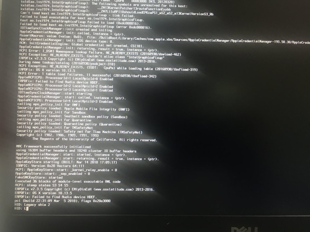

liemhatang Posted May 9, 2018 Share Posted May 9, 2018 Hi all. My system: Processor : Intel Core i7-6600U Processor Graphics Processor(GPU) : Intel Integrated HD Graphics 520 Chipset : 6th Generation Intel Storage : hynix 256GB M.2 Form factor Sata-SSD RAM : 8GB DDR4 SDRAM 2400 MHz; 2 slots supporting up to 16GB Wifi : DW1560 LAN : Intel I219-LM PCI-E Gigabit Ethernet Adapter Audio : Realtek High Definition Audio ALC293 (ALC3235) USB 3.0 : Intel USB 3.0/3.1 xHCI Controller Touchpad : Alps Multi-touch Touchpad v7 Hardware Webcam : USB3.0 UVC HD WebCam Card reader : SD 4.0 Memory Card Reader Monitor : (14) FHD (1920x1080) Anti Glare (16:9) WLED, 300 nits, Magnesium Alloy LCD back Battery : 55 Wh ExpressCharge Capable (4-cell) Lithium-Ion Interface : 1 x Microphone/Headphone Combo jack 1 x Mini DisplayPort for external monitor 3 x USB 3.0 port(s) (one with PowerShare) 1 x RJ45 LAN Jack for LAN insert 1 x HDMI i install 10.13.4 boot with change DVMT BIOS. but i don't want config BIOS, update bios to 1.18.5. add Lilu.kext + IntelGraphicsDVMTFixup to Clover kext but not boot. Help me. Link to comment Share on other sites More sharing options...
Moderators Jake Lo Posted May 9, 2018 Moderators Share Posted May 9, 2018 KP is due to ACPI error, not Lilu+IntelGraphicsDVMTFixup since you make changes to the BIOS. Here replace it to /E/C/ACPI patched.zip 1 Link to comment Share on other sites More sharing options...
liemhatang Posted May 9, 2018 Author Share Posted May 9, 2018 Not work again Link to comment Share on other sites More sharing options...
Moderators Jake Lo Posted May 9, 2018 Moderators Share Posted May 9, 2018 Reset BIOS to load default. Apply and then change to UEFI, AHCI, Legacy Options ROMs disabled, secure boot disabled Reboot to Clover and re-extract raw files with F4 attach for re-patch Link to comment Share on other sites More sharing options...
