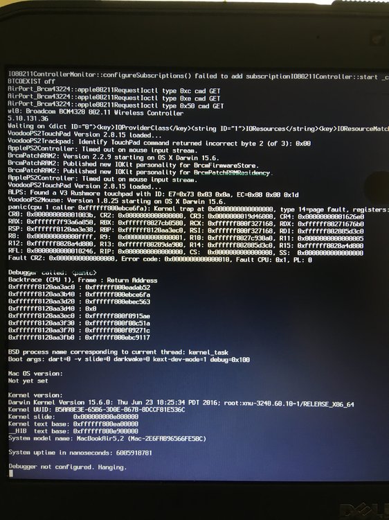

Hi. I'm having trouble trying to install Mac OS X El Capitan on the Dell Latitude E5430 non-vPro. The Dell restarting before you even complete the startup of the installer. I used unifail 6.2.0

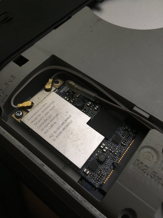

to generate the installer. I was able to install Mac OS High Sierra perfectly, however my Wifi card is no longer compatible with the system. It's a board that can be taken at iMac 2008. It BCM94321MC. So my preference for El Capitan. I'm sending my CLOVER folder that I use to boot via USB if I need to parse. Thanks any kind of help!
Sorry for my awful English. I'm brazilian.

Known issue for years. I had this posted in my Clover guide
 ⚠️⚠️⚠️ Notes3:
To prevent artifacts with HD 4000, the following models should not exceed BIOS A11.
Downgrade to A02/A03 and then upgrade to A11 if it has exceeded: E6x30, E5x30
