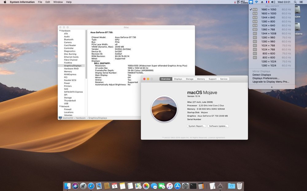

Administrators Hervé Posted December 4, 2018 Administrators Share Posted December 4, 2018 Switched to macOS default driver and the card works OOB as expected. No issues, everything runs perfectly, no glitch like yours. Please note that I'm running with latest Lilu kext v1.2.8 (not v1.2.7) and without WEG. I guess it could be an issue with Mojave itself. Will have to install it on a separate partition to compare. Is your GT730 running glitch-free under High Sierra? Have you tried it without Lilu & WEG? Link to comment Share on other sites More sharing options...
Administrators Hervé Posted December 5, 2018 Administrators Share Posted December 5, 2018 Have now tried the card under Mojave and I still have no issues whatsoever. The card works OOB as expected and without any "glitches". Link to comment Share on other sites More sharing options...
Lysergatek Posted December 5, 2018 Author Share Posted December 5, 2018 Oh ! You didn't used WhateverGreen ? This may be the issue, I always thought I needed both Lilu and WhateverGreen ! I'll try without it and come back there ! Link to comment Share on other sites More sharing options...
Lysergatek Posted December 5, 2018 Author Share Posted December 5, 2018 Okay so no luck, it effectively works without WhateverGreen, but I still have the same issue under load (like Cinebench's OpenGL benchmark, or OpenGL Extensions Viewer's benchmark) Link to comment Share on other sites More sharing options...
Administrators Hervé Posted December 5, 2018 Administrators Share Posted December 5, 2018 I've not found a need to use Lilu + WEG for graphics acceleration/GT730 support purposes. All in all, your issue could be related to the display device you use rather than your Mojave installation per sé. Maybe you could try and play with SwitchResX app to adjust settings like pixel rate or things like that. Or do some checking/injection of the EDID info. Link to comment Share on other sites More sharing options...
