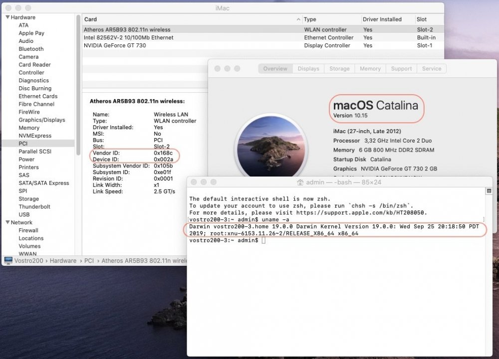

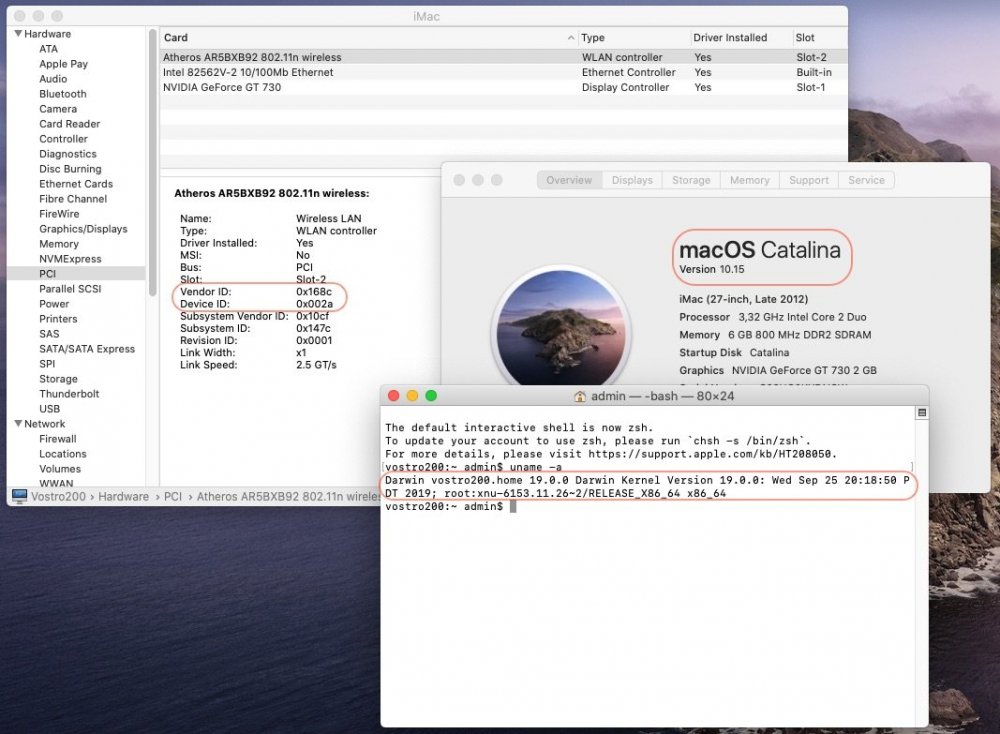

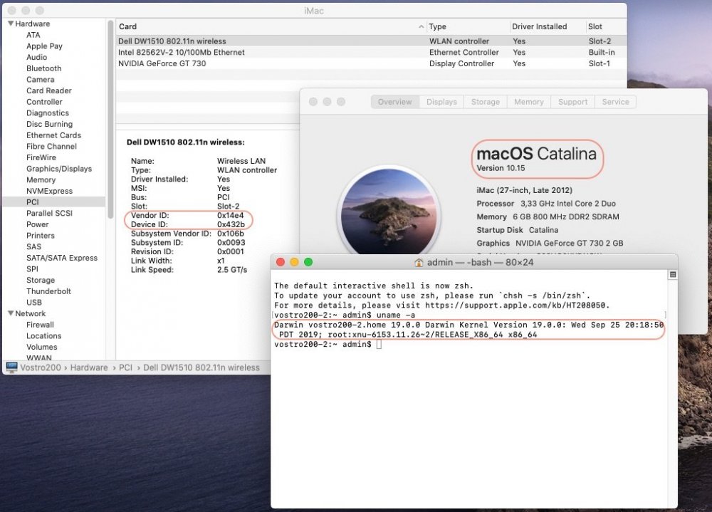

For Catalina 10.15:
1/ DW1510/Broadcom BCM4322-based cards require replacing the vanilla IO80211Family kext in /S/L/E by Mojave's (or High Sierra's) version. Of course, Catalina system partition must first be mounted in RW mode to that effect (see our FAQ section for details). No need to replace IO80211FamilyV2 kext at all.
DW1510 802.11n 2.4/5GHz card:

Atheros AR5BXB92 (AR9280) 802.11n 2.4/5GHz:
Atheros AR5B93 (AR9283) 802.11n 2.4GHz:
