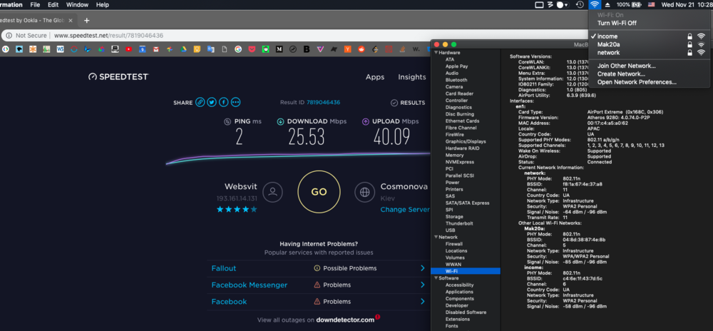

pathliving Posted November 21, 2018 Share Posted November 21, 2018 Can anyone share kext with good speed on this wi-fi module AR5B93, because I changed channel width to 40MHz, set Auto channel, 11bgn Mode, enable WMM, tested Transmit Power (low, middle, high) in my wi-fi router TP-Link TL-WR841ND, but nothing to help p.s. I am using AirPortAtheros40.kext and my laptop has 20-30mbps speed with this wi-fi module (for comparison my phone Nexus 6P has 50-60mbps speed. and on Windows 10 with AR5B93 laptop has ~50mbps speed) Link to comment Share on other sites More sharing options...

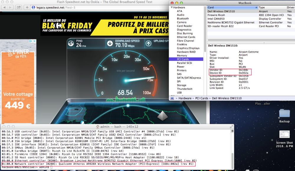

Administrators Hervé Posted November 21, 2018 Administrators Share Posted November 21, 2018 You could have specified that subtlety from the onset... Atheros cards are no longer officially supported in Mojave so feel free to test Atheros40 kext from other versions if you're game. You can always extract the kext with Pacifist app from past Combo Update packages available for download off Apple's web site. Failing that, opt for a better card like DW1510; AR5B93 is getting a little long in the tooth today... I took out my old little Latitude D430 out of its cupboard and replaced the DW1510 fitted into it by the AR5B93 card I have lying around. It's this exact Foxconn T77H047 card. 'booted ML and ran Ookla legacy tests. Results are as good as I expected at around 70-80Mbps: Try and adjust your local connection settings. Good luck. 1 Link to comment Share on other sites More sharing options...
pathliving Posted November 21, 2018 Author Share Posted November 21, 2018 You are right, I should have bought a DW1510 card, but not atheros.. This is 2 screenshots with my wi-fi routers and last with DHCP cable Link to comment Share on other sites More sharing options...

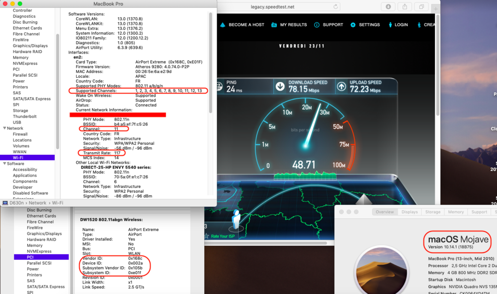

Administrators Hervé Posted November 21, 2018 Administrators Share Posted November 21, 2018 Ok, took the DW1520 out of my D630 that runs Mojave 10.14.1 and replaced it by the AR5B93 card + installed 10.13.6's Atheros40 kext posted here. The results are more or less identical to what I obtained with the D430: Whilst your network are listed as 802.11n, I can see that the card only achieves a connection at a transmit rate of 11Mbps when my card achieves 117 to 130Mbps. This is clearly where your issue is. AR5B93 is 2.4GHz only and my router only offers 20MHz channels, not 40MHz. Maybe you should stick to 20MHz... Could also be linked to eventual limitation with Country Code... Link to comment Share on other sites More sharing options...
