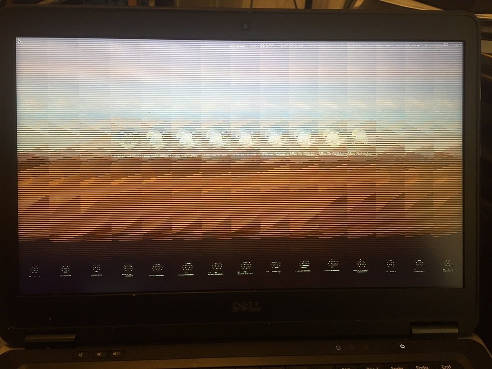

brainyboy345 Posted December 24, 2018 Author Share Posted December 24, 2018 nope havent had any luck and ive tried everything. I want to get the 1920x1080 as everyone else has it working Link to comment Share on other sites More sharing options...

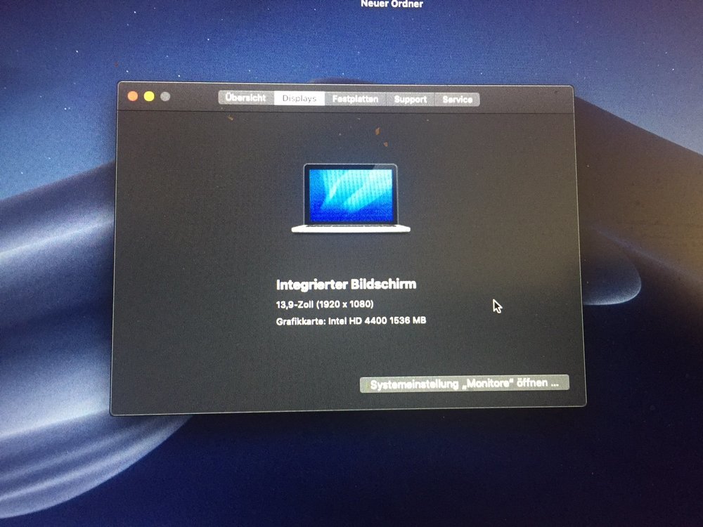

Fritz00 Posted January 19, 2019 Share Posted January 19, 2019 @brainboy345 Please try the following: If you reach your garbled (login) screen press power the button for one second to swich off the screen (sleep mode). If the screen is dark press the power button again to switch on the screen. Then you probably get a nice login screen in 1920x1080 resolution. It works on my E7440 with Mojave. Link to comment Share on other sites More sharing options...
Moderators Jake Lo Posted January 19, 2019 Moderators Share Posted January 19, 2019 @Fritz00 Just enable Legacy Option ROMs in the BIOS will fix that. Link to comment Share on other sites More sharing options...
Fritz00 Posted January 19, 2019 Share Posted January 19, 2019 @Jake Lo Thank you. It works. Link to comment Share on other sites More sharing options...
