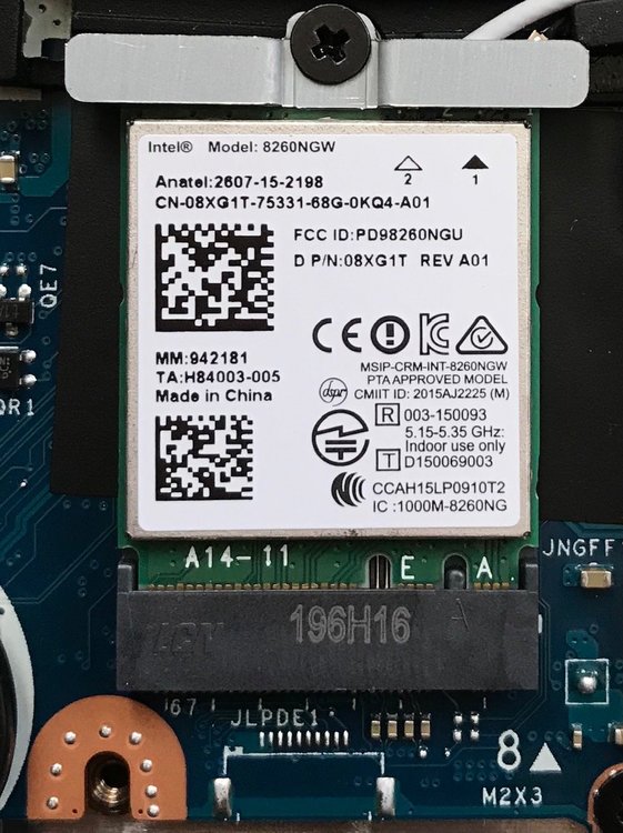

LeMarsu Posted March 26, 2019 Share Posted March 26, 2019 First of all Thank you very much for the great installation instruction. Was able to follow all with no issues, (apart from the ESP Mounter Pro not working for me in the Hack_Tools, ended up using Clover Config to mount the ESP). My current issue is getting the Wireless Network Card working on the Dell Latitude E7270 using Mojave, I have seen some details that it didn't work pervious OSX, but issues resolved now. Can you please guide me to how to get this working or point me to a thread? I have attached the debug details let me know if there is anything more I can supply. Thanks debug_19895.zip Link to comment Share on other sites More sharing options...
Moderators Jake Lo Posted March 26, 2019 Moderators Share Posted March 26, 2019 It would help if you have stated what wifi device it has. But looking at your raw IOREg file, it appears to show an Intel which is NOT supported in MacOS. Replace the card with a DW1560 is my recommendation. Link to comment Share on other sites More sharing options...
LeMarsu Posted March 26, 2019 Author Share Posted March 26, 2019 Apologies, it is a Intel® Dual Band Wireless-AC826 (8260NGW) Would it possible to use this? I would like to get configured before travelling Link to comment Share on other sites More sharing options...
Moderators Jake Lo Posted March 26, 2019 Moderators Share Posted March 26, 2019 As I stated above Looking at your raw IOREg file, it appears to show an Intel which is NOT supported in MacOS. Replace the card with a DW1560 is my recommendation. Link to comment Share on other sites More sharing options...
