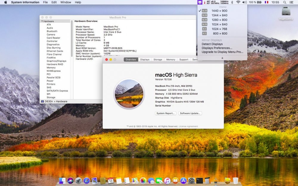

Target OS X release:
  • El Capitan 10.11.x (all versions)
  • Last OS X version supporting Core2Duo Merom CPUs (Eg: T7x00)
This is an Enoch-based installation using the well-known/well-documented vanilla manual method detailed below:

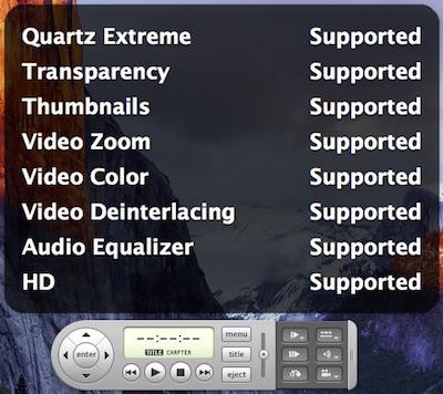

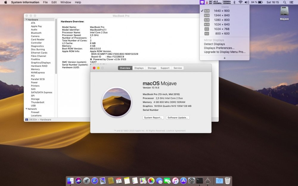

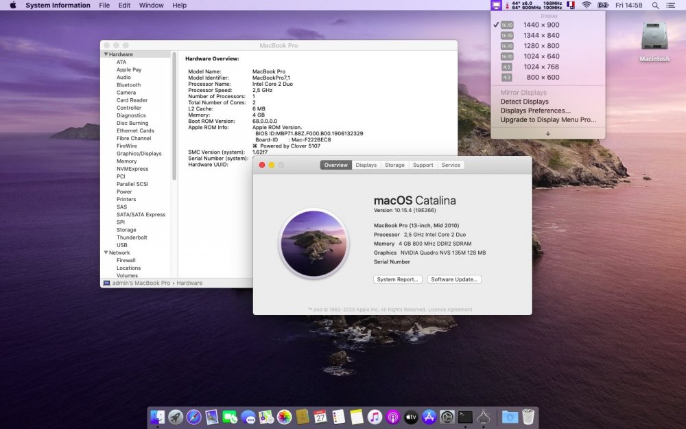

Edit: 22 Mar 2020
  • Revised AGPM tuning included into FakeSMC kext for better GPU throttling and lowered T°.

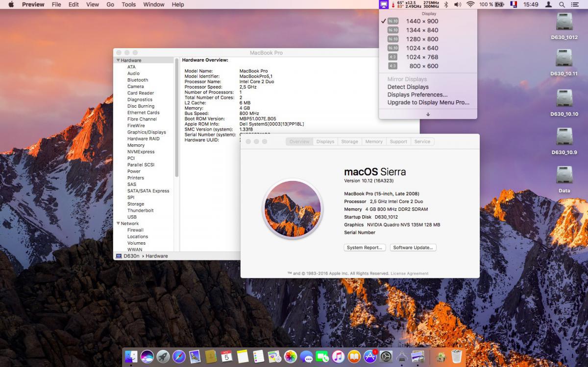

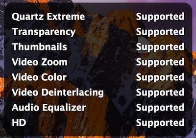

  • Copy the 2 hidden files (BaseSystem.dmg & Basesystem.chunklist) of InstallESD.dmg to the root of your USB key
cp /Volumes/OS\ X\ Install\ ESD/BaseSystem.* /Volumes/OS\ X\ Base\ System\ 1
  • Install Enoch r2839 (latest at time of writing) on the USB installer
  • Copy the above Enoch r2839 installer package to the root of the USB installer
  • Copy the following D630n bootpack to the root of the USB installer
  • Create a folder called Kernels under /System/Library (normally, it won't exist at that stage)
  • Copy the appropriate Sierra vanilla kernel to /System/Library/Kernels. Copies of the kernels are available here.
2) 10.12 installation
  • Boot the 10.12 USB installer (it may take a little time to kick in) with -f -v boot flags
  • If/when prompted for USB keyboard and/or mouse at installer startup, just press [sPACE] or [ENTER] key
  • At macOS installer main screen, open up Disk Utility in Utilities menu
  • If applicable, partition your target disk in GPT/GUID scheme
  • Create your target 10.12 partition and format it as OS X Extended (Journaled)
  • Close Disk Utility and proceed with macOS 10.12 installation as usual
3) Post-installation fine-tuning
  • Reboot the 10.12 USB installer (it may take a little time to kick in)
  • If/when prompted for USB keyboard and/or mouse at installer startup, just press [ENTER] or [sPACE] twice
  • At macOS installer main screen, open up Terminal in Utilities menu
  • Verify CoreStorage installation disk mode:
diskutil list
  • If CoreStorage activated for Fusion drive, revert to legacy mode:
diskutil corestorage revert <device> (for example: /dev/disk1)
  • Identify your freshly made 10.12 partition name
df
  • Copy the Extra folder from the USB installer to your identified 10.12 disk partition
cp -R /Extra /Volumes/<your fresly made 10.12 partition name> (for example: cp -R /Extra /Volumes/OSX_disk)
  • Reboot the 10.12 USB installer, press a key at delay bar (or F8) to interrupt boor process and select your freshly made 10.12 disk partition. You'll then be booting Sierra for the 1st time
  • Complete the 1st boot installation finalisation
  • Once at the 10.12 desktop, run the Enoch r2839 package from your USB installer to install Enoch on your HDD; it should be installed on the 1st partition of the disk
  • Eject the 10.12 USB installer and put it aside
  • Copy all kexts from /Extra/Extensions to /Library/Extensions (ignore and acknowledge the permissions-related error messages)
  • Repair kexts permissions and rebuild cache (if you end up with "Error 77..." message, repeat the touch + kextcache commands)
sudo chmod -Rf 755 /L*/E*
sudo chown -Rf 0:0 /L*/E*
sudo touch -f /L*/E*
sudo kextcache -Boot -U /
  • Edit /Extra/kernel.plist and set KernelBooter_kexts parameter to No
<key>KernelBooter_kexts</key>
<string>No</string>
  • Disable hibernation (can be done later, but should be done): open up Terminal and type the following commands
sudo pmset hibernatemode 0
sudo pmset hibernatefile /dev/null
sudo rm -f /var/vm/sleepimage
  • Sierra can subsequently be updated through AppStore updates or combo updates without further tuning action
Please note that:
  • Sierra requires a Penryn CPU with SSE4 instructions set (e.g. T6xxx, T8xxx, T9xxx with FSB 800MHz). Merom CPUs (e.g.: T5xxx, T7xxx) do not have such instructions set and do not allow Sierra installation.
  • Sierra installation is not supported with MBP5,1 SMBIOS profile (although Sierra can subsequently run with that SMBIOS). Hence the switch to MBP7,1 profile. FakeSMC SMC keys + AGPM tuning revised accordingly (GPU (i.e. AGPM) performance tuning has been injected into FakeSMC kext and no longer requires additional action at this stage).
  • the DSDT was modified to rename USB2.0 controllers to EH01/EH02; failing that, Sierra does not recognise any USB2.0 ports/devices.
  • USB ports all functional thanks to D630-specific USB_injector kext (DSDT-described ports injected to MBP7,1 profile).
  • VoodooHDA + AppleHDADisabler kexts have to be placed in /L/E in order to load (they don't load from /E/E).

This is a Clover-based installation using the well-known/well-documented vanilla manual method detailed below:
Working:
  • full QE/CI with nVidia Quadro NVS 135m OOB
  • VGA output OOB (display extension or mirroring)
  • full audio, including jack microphone input and headset output (with VoodooHDA v2.8.x & AppleHDADisabler kexts in /L/E)
  • built-in Gigabit Ethernet (with BCM5722D kext v2.3.6)
  • DW360 bluetooth OOB
  • native CPU speedstep (with SMC-tuned Kozlek's FakeSMC v6.13.1363 and MBP7,1 SMBIOS profile)

Target macOS release:
  • Sierra 10.14.x (all versions)
  • :excl: For models with Penryn CPUs only :excl:
Proceed with the knowledge that, lack of Metal compatibility of Tesla GPUs oblige, only OpenGL graphics acceleration can be achieved. It works Ok but graphics bugs and/or degraded performance may be noticeable especially with Finder or when watching a movie in Netflix (video may be slightly jerky). It's not totally as smooth as in High Sierra.
Working:
  • OpenGL-only graphics acceleration with nVidia Quadro NVS 135m (after specific tuning)
  • VGA output (display extension or mirroring)
  • native GPU throttling (with above AGPM-tuned Kozlek's FakeSMC)
  • sleep through lid closure, Fn-Esc, Apple menu->Sleep, power button (Press ALT-CMD/Win-PWR or CTRL-PWR for power options menu) and energy savings settings (all with hibernation disabled)
  • wake through lid opening and power button
  • wireless with any compatible card
  • battery management and monitoring (with ACPIBatteryManager kext v1.81.4)
  • rear + right USB2.0 ports (with USBInjectAll kext v0.7.1)

1) 10.14 USB installer creation
  • Using a USB key of 8GB minimum, create a Mojave USB installer through the following Terminal command:
sudo <path>/Install\ macOS\ Mojave.app/Contents/Resources/createinstallmedia --volume /Volumes/<USB key>
  • where:
    • <path> = location of Mojave installation package (eg: /Applications if freshly downloaded)
    • Install Clover in the ESP
    • Boot Sectors -> Install boot0af in MBR
    • Clover for BIOS (legacy) booting -> Clover EFI 64-bits SATA
    • BIOS Drivers, 64 bit -> ApfsDriverLoader / FSInject / HFSPlus / SMCHelper
    • BIOS Drivers, 64 bit -> GrubEXFAT / GrubNTFS
  • you may use version r5097 attached below or any subsequent version available at Dids' Github repo:
  • open this EFI partition and transfer the files & folders from the D630n Mojave Clover pack below to the EFI/Clover folder. This pack contains 2 x Clover config files: the default one with MBP7,1 SMBIOS which is required to gain CPU power management and a 2nd one called "config_MBP9,1" with MBP9,1 SMBIOS which is required for Mojave installation and updates
  • copy High Sierra 10.13.6's telemetry plugin below to the root of your USB installer
  • copy Mojave's PlaformSupport plist below (patched to support MBP7,1 platforms) to the root of your USB installer
  • copy Clover package + Clover Configurator app to the root of your USB installer for subsequent use later
2) Basic 10.14 installation (no Telsa dGPU support/no graphics acceleration)
  • boot the Mojave USB installer
  • at the Clover main menu, go "Options" then "Configs" and select "config_MBP9,1" (Press [ENTER] each time). Press [ESC] a couple of times to return to Clover main menu
  • at the Clover main menu, select the "Install macOS Mojave" partition but don't press [ENTER]
  • press [SPACE], select -v verbose option in the menu, then boot with the selected options
  • proceed with installation, 1st creating & formatting the target Mojave partition through Disk Utility as/if required (GUID scheme, HFS (journaled) format)
  • on 1st reboot, boot from the USB installer again and select "config_MBP9,1" config file again
  • return to the Clover main menu and boot the freshly created "macOS Install from <target Mojave partition>" temporary partition
  • repeat this reboot sequence until the temporary partition is no longer offered and only the target Mojave partition is offered, marking the effective completion of Mojave's installation
  • reboot the USB installer as it if were the 1st time again (or the Recovery partition via the USB installer) and, once at the macOS installer main screen, open up Terminal from Utilities menu
  • copy 10.13.6's telemetry plugin to Mojave's target partition to avoid SSE4.2-related KP/reset on Core2Duo at boot time (required after each update😞 )
cp -Rf /Volumes/Image\ Volume/com.apple.telemetry.plugin /Volumes/<target Mojave partition>/System/Library/UserEventPlugins/
  • copy Mojave's patched PlatformSupport plist to Mojave's target partition to support booting Mojave with MacBookPro7,1 SMBIOS
cp -f /Volumes/Image\ Volume/PlatformSupport.plist /Volumes/<target Mojave partition>/System/Library/CoreServices/
  • exit Terminal and restart your computer. Reboot the target Mojave partition via your USB installer with default config file.

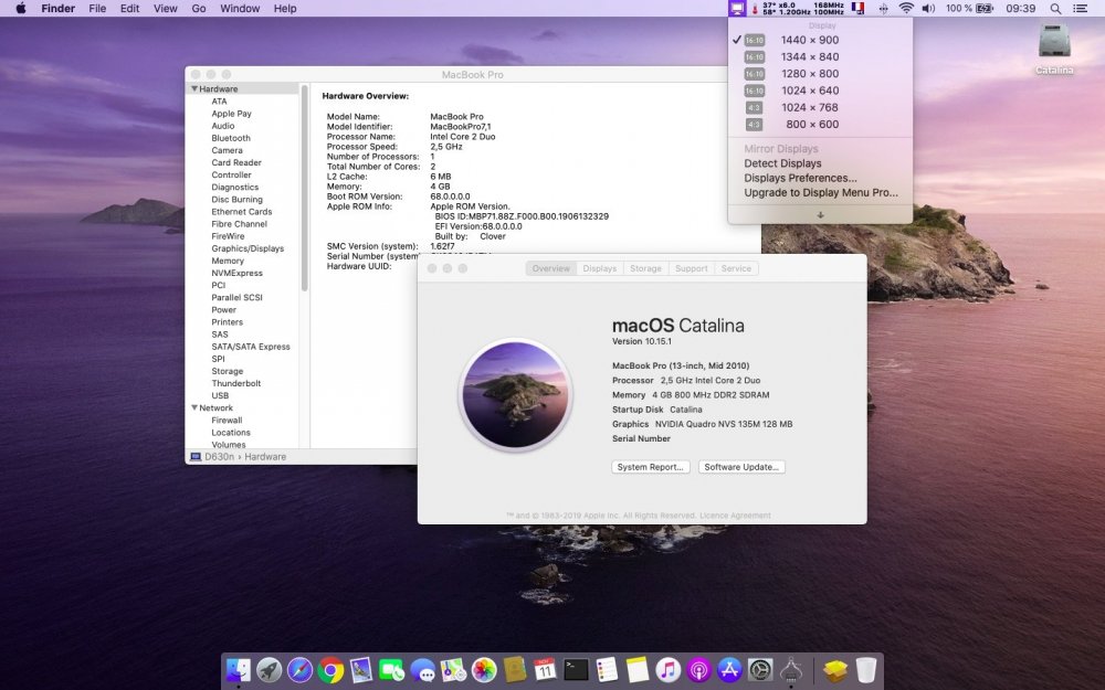

Working:

3) Post-installation basic tuning
  • Once the target Catalina partition has booted, complete the 1st boot system setup
  • Once at the desktop, install Clover bootloader on the Catalina partition/disk with the customised settings listed above
  • Once Clover is installed, launch Clover Configurator app and mount the freshly created EFI partition of the Catalina partition/disk
  • Open this EFI partition and transfer the files & folders from the above D630n Catalina Clover pack to the EFI/Clover folder
  • You may then reboot and verify that Catalina boots off your disk through Clover

macOS Catalina should then complete full boot and now run with (OpenGL-only) graphics acceleration. Note that this entire graphics-tuning process will require to be repeated after each Catalina update.

Catalina 10.15.4 update  is out but not to be installed on unsupported legacy platforms with Tesla graphics such as the D630 until the new patch is fully sorted out. The method described above works up to 10.15.3 but does not with 10.15.4 due to AMFI-related issues and will result in systematic KP or hanging at boot time, depending on library validation being enabled or not.
I was able to obtain OpenGL-only graphics acceleration by making a fresh Catalina 10.15.4 installation with DosDude1's patcher. I wish I would have had time to suss out the detailed post-install patching process for upgrades from earlier Catalina versions but I've just sold the D630 and it's going today.
My contribution to installing macOS on this old lady therefore stops here... It was fun for the many years it lasted. Leopard 10.5 to Catalina 10.15 has been a pretty good, not to say impressive, run...
