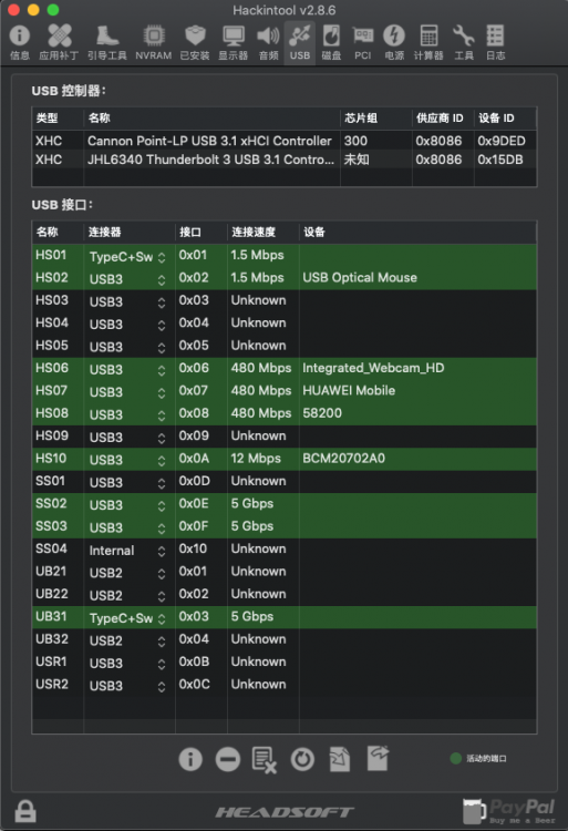

dennisc Posted November 5, 2019 Share Posted November 5, 2019 Hi friends, after following Herve's guide and many others tips on the forum for this specific latitude7400, I have been implemented most of the functions,but 5 features can't work which may be caused by USB ports limited (Canno Point-LP USB 3.1 xHCI Controller). No Detecting(but Win10 works): Bluetooth(DW1560 pin-masking 5 pins, Lenovo version, it works better on another Hackintosh) WWAN Card (Huawei ME906C) IR Camera two USB 3.0 ports(only U disk works, but mouse can't) microSD Card Reader Working: I7-8665u with CPUFriend intel UHD Graphics 620 2048MB Audio ALC295 layout-id 77 WLan with DW1560 I2C Touchpad Screen Backlight control with Fn+F6/F7 Sleep and Wake Thunderbolt 3 USB 3.1 Controller(test U disk, mouse, charging) the clover and ioregistry files in attachment. EFI.7z ioregistry.7z Thanks! Dennis C 1 Link to comment Share on other sites More sharing options...
dennisc Posted November 8, 2019 Author Share Posted November 8, 2019 Solved! According to Hervé's post , I rebuild the config.plist again, and use the MacBookPro15,2 model(four thunderbolt) . Now, they can work: [done] Bluetooth(DW1560 pin-masking 5 pins, Lenovo version, it works better on another Hackintosh) [done] WWAN Card (Huawei ME906C) [done] Integrated_Webcam_HD (IR Camera also unsupported) [done] two USB 3.0 ports(only U disk works, but mouse can't) microSD Card Reader unsupported. PS: Audio ALC295 layout-id has change to 13. the `config.plist` file in attachment. config.plist.zip Link to comment Share on other sites More sharing options...
