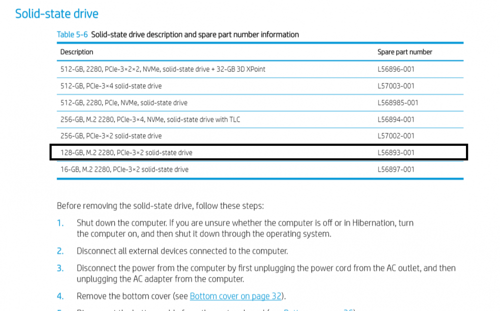

Raffay Posted December 7, 2019 Author Share Posted December 7, 2019 @Jake Lo This system has built-in SSD. I'm trying to identify the manufacturer and model but strangely unable to find. Can you help me in this regard? I have attached the info I'm able to find. And one more thing, I only want to install macOS on my HDD. Windows will reside on SSD. I had attached the clover folder as well. CLOVER.rar Link to comment Share on other sites More sharing options...
Moderators Jake Lo Posted December 7, 2019 Moderators Share Posted December 7, 2019 You might be able to check it in the BIOS, if not you'll need to take off the back cover and find it physically. Even though it's not being install to the NVMe drive, just having it detected causes issue. Try disabling it in BIOS and see if you could get the Installer to advance. Link to comment Share on other sites More sharing options...
