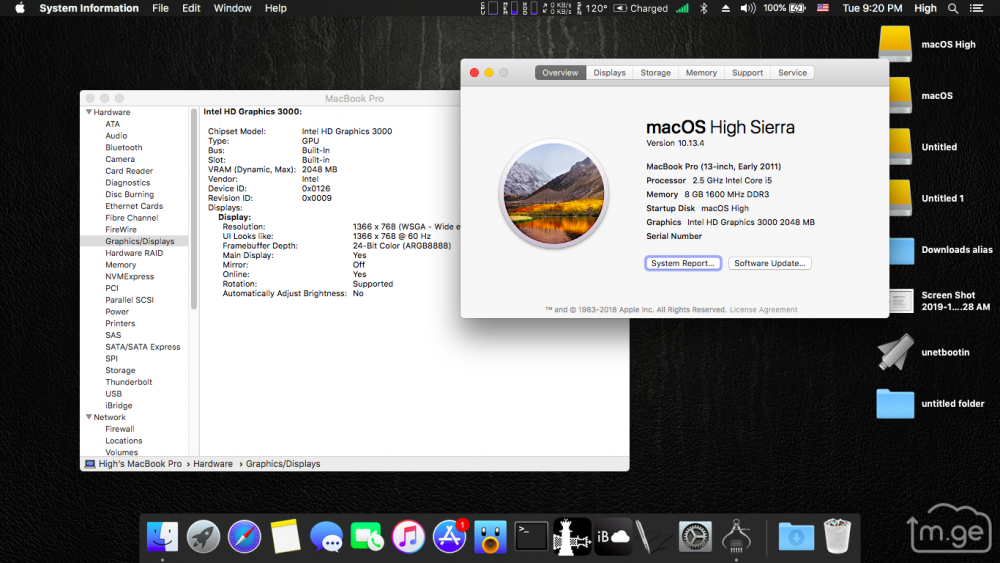

ghaffari Posted December 17, 2019 Share Posted December 17, 2019 I followed the guide here in the forum to install high Sierra and it's fully work accept the intel hd graphics it just give me 512 mb any solution https://imge.to/i/vJLIK6 followed this guide Link to comment Share on other sites More sharing options...
Moderators Jake Lo Posted December 17, 2019 Moderators Share Posted December 17, 2019 In the Config file under KextToPatch are 2 patches, one for 1GB, the second for 2GB. Currently they are set to disabled YES, change either one you chose to NO will increase the vram 1 Link to comment Share on other sites More sharing options...
Administrators Hervé Posted December 17, 2019 Administrators Share Posted December 17, 2019 Standard/default VRAM settings for HD3000 are: 2GB RAM -> 256MB VRAM 4GB RAM -> 384MB VRAM 8GB RAM -> 512MB VRAM That's Apple's own settings, defined in the SNB framebuffer. As such, what you obtain is perfectly normal. Any changes from those settings result from framebuffer patching and I've included those (in disabled mode) in the Clover config files I posted in my guide, at least the latest ones, probably not the earliest ones. Details for HD3000 VRAM increase are available in many Mac and Hackintosh forums. Here for instance. 1 Link to comment Share on other sites More sharing options...
