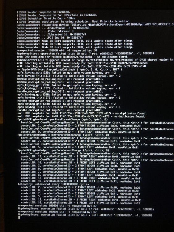

Moderators Jake Lo Posted January 24, 2020 Moderators Share Posted January 24, 2020 what's the issue with booting from the drive? Reason you don't have touchpad and audio is because you're booting from the USB drive without the proper bootpack. Let's figure out why you can't boot from the drive, need more detail... Do you see Clover boot screen? At Clover, press the spacebar Select verbose + debug 0x100 mode Post boot issue detail where it hang or KP Link to comment Share on other sites More sharing options...

DMC Posted January 24, 2020 Author Share Posted January 24, 2020 I think yes, i didnt have time to wait longer but I try soon Link to comment Share on other sites More sharing options...
DMC Posted January 24, 2020 Author Share Posted January 24, 2020 Theres new command with AppleACPICPU Link to comment Share on other sites More sharing options...
DMC Posted January 24, 2020 Author Share Posted January 24, 2020 Okay its loaded into apple logo Link to comment Share on other sites More sharing options...
DMC Posted January 24, 2020 Author Share Posted January 24, 2020 But its stuck on this apple logo all the timr Link to comment Share on other sites More sharing options...
Moderators Jake Lo Posted January 24, 2020 Moderators Share Posted January 24, 2020 Reboot with the installer if that allows you to get into the MacOS The download this version of Clover and install with the following settings Install for UEFI booting only Install Clover in the ESP UEFI Drivers\Recommended Drivers ApfsDriverLoader AptioMemoryFix AudioDxe DataHubDxe FSInject HFSPlus Additional drivers PartitionDxe Themes (Optional) Link to comment Share on other sites More sharing options...
