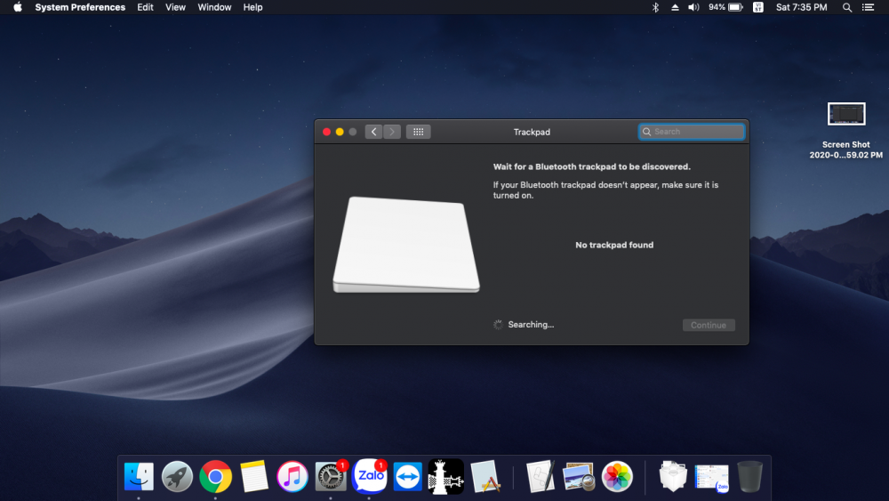

doanuprom Posted April 4, 2020 Share Posted April 4, 2020 My dell e7270 run 10.14 mojave. i use EFI forder in topic: https://osxlatitude.com/forums/topic/9179-dell-latitude-e7x70-clover-uefi-only/ Everything work good but trackpad not show options in Settings My Clover forder: Clover.zipClover.zip Link to comment Share on other sites More sharing options...

doanuprom Posted April 4, 2020 Author Share Posted April 4, 2020 after replace setting -> trackpad not found Link to comment Share on other sites More sharing options...
Moderators Jake Lo Posted April 4, 2020 Moderators Share Posted April 4, 2020 I probably should add a note in the guide regarding Alps v7/8 support. Currently there is NO Alps kext that would run smoothly on E7270/ E7470, that's why I have ApplePS2Controller.kext in my bootpacks for models with Alps touchpad above v5. Although it doesn't detect it in Trackpad preferences it'll work perfectly smooth. 2 fingers scrolling works(only up and down, not sideway), 2 fingers right click, drag and drop. There is a slight issue with CAPS lock, you'll need to tab twice to lock and twice to unlock. As for VoodooPS2ControllerR6Bronxteck.kext, although it fixes the CAPS lock issue, I find it harder to use. It's not as smooth, perhaps I could adjust the ZFinger value for better support but I have not bother to since it disables the Trackstick on the E7470 and E7450 which I prefer over Trackpad. With the additional 3rd party software like SmartScroll.app, I was able to scroll smoothly up and down, side to side with ApplePS2Controller.kext. I guess it's up to your preference since E7270 does not have the Trackstick. 2 Link to comment Share on other sites More sharing options...
