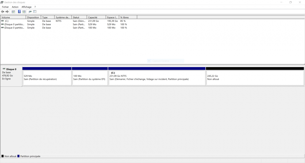

Jeepey Posted June 16, 2020 Share Posted June 16, 2020 Hello, I'm new on this website. I bought a dell latitude 7490 few days ago and I would like to do an hackintosh on it. I don't speak english very well and I would like help with my installation. I found this tuto : It is really good but I have some trouble. I would like to do a dualboot on my M.2 2280 512GB SATA SSD (in Key M slot) with windows 10 who is already install and Catalina 10.15. My specs are exactly the same as those in the tuto. I don't know how to do a dualboot when I follow the tuto and what to do not lose my data and my windows 10 os. So my questions are : Do I need to downgrade my bios version (it's v1.14.0) Can I do a dualboot ? Will I lose my data ? To do the "well-known/well documented vanilla method", do I need to make the "boot USB key" with a virtual machine ? (I don't have a macbook at home) Thank you for your answers. Link to comment Share on other sites More sharing options...
Moderators Jake Lo Posted June 16, 2020 Moderators Share Posted June 16, 2020 Hi @Jeepey 1) No, any BIOS version is fine. Just remove the DSDT.aml from the files in the tutorial. 2) Yes, but you need to make sure the EFI partition is at least 200MB. MacOS requires 200MB, Windows by default is 100MB I believe. You'll need to figure out how to do that with google. Make sure your drive is currently formatted to GUID. Yes Windows can run on GUID. 3) If you do it correctly, you won't lose any data, but always a good idea to backup 1st. 4) Usually best to create installer from a real Mac or Hackintosh, VM is less reliable but some had succeeded without issue. So you can try and see. Link to comment Share on other sites More sharing options...
Jeepey Posted June 16, 2020 Author Share Posted June 16, 2020 @Jake Lo Thank you for your answer. I remove just the "DSDT.aml" and it's fine ? My EFI part is 100MB so I have to extend it ? I need to have a 300MB EFI part because Windows need 100MB and Macos 200MB ? When you say " Make sure your drive is currently formatted to GUID." How can I be sure that my drive is formatted to GUID ? It's done. I just don't want to broke my windows. Do you have a tuto of that on this siteweb ? Link to comment Share on other sites More sharing options...

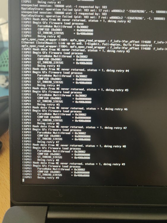

Jeepey Posted June 17, 2020 Author Share Posted June 17, 2020 I did step by step the above tuto. I tried the tuto for Mojave 10.14.x with 10.14.6. I did exactly that : I downloaded the dmg file from apple store (8gb) I format my USB key with that : diskutil partitionDisk /dev/disk# GPT JHFS+ "USB" 100% I install the dmg Mojave with this : sudo "/Applications/Install macOS Mojave.app/Contents/Resources/createinstallmedia" --volume /Volumes/USB I install Clover r4919 (and I tried the r5093 and r5119) on my USB with exactly theses settings : " Clover for UEFI booting only Install Clover in the ESP UEFI Drivers AudioDxe-64 DataHubDxe-64 FSInject-64 SMCHelper-64 ApfsDriverLoader-64 AppleImageLoader-64 AptioMemoryFix-64 Fat-64 HFSPlus NvmExpressDxe-64 PartitionDxe-64 Ps2MouseDxe-64 UsbKbDxe-64 UsbMouseDxe-64 Themes (optional) Install Clover Preference Pane (optional)" I lunched Clover Configurator but the EFI part was already mount. I cospy/past this : "7490_Mojave_Clover_Pack_#8.zip" in EFI/Clover I put my USB key on my computer and it's not working ... I did the same for 10.15.x with the lastest version of Catalina. And no succes too ... I tried everything (with injected kextts, without injected kexts), change the version of Clover. I put the good BIOS settings, I downgrade my BIOS version from 1.14 to 1.13.1. I tried really everything but it's not working. I'm doing it for 17 hours now ... The latest version that I tried was the 10.14.6 version tuto. I'm with a virtualbox macos 10.15.4 Catalina. My usb is a 16gb 3.0 USB I have the exact same computer that in the tuto. I took some pictures of my "errors" when I try : Normal settings (nothing changed, just -v as boot settings) When I do with injected kexts when I do without injected kexts. Please help me, I will tilt so much ... Link to comment Share on other sites More sharing options...
Moderators Jake Lo Posted June 17, 2020 Moderators Share Posted June 17, 2020 If you're installing Catalina, make you have Clover v5107 at minimum. When using the bootpack, make sure the contents of the zip are extracted into /EFI/Clover. Boot with -v debug=0x100 -igfxvesa If booted, continue using the same arg until installation is completed Back to your Windows format, check if it's MBR. If it is, you'll need to convert it to GUID. I'm not sure if it's possible. I never had to do it before I had always install MacOS, then Windows. Link to comment Share on other sites More sharing options...
Administrators Hervé Posted June 17, 2020 Administrators Share Posted June 17, 2020 Erm... just for the sake of clarity, you didn't just copy the zipped Clover pack to your EFI/Clover folder did you? Instead, you unzipped it and copied/pasted the unzipped contents then removed the patched DSDT, right? If you're installing latest version of Catalina, i.e. 10.15.5, you may want to boot with -disablegfxfirmware boot arg. I had found it to be required when updating to 10.15.4 as stated here. Don't use any Clover version older than r5117. As suggested by Jake Lo, there was no need to downgrade BIOS to v1.13.1 at all, the 7490 runs macOS just fine with v1.14.0. Link to comment Share on other sites More sharing options...
