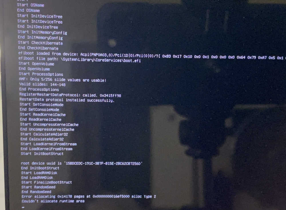

linuxchan6 Posted July 12, 2020 Share Posted July 12, 2020 I am dual booting Windows 10 and Mojave for many months. Each OS is in its separate drive. After Bios upgrade from 1.9.0 to 1.14.2, when I tried to boot to Mojave, It stuck at Error allocating 0x14198 page at 0x000000001749a000 alloc type2. Couldn't allocate runtime area. The error message remains even reverted back to 1.9.0. Any help is appreciated. Link to comment Share on other sites More sharing options...
Moderators Jake Lo Posted July 12, 2020 Moderators Share Posted July 12, 2020 Best to post full screenshot of KP Last line of message might not always be the issue Link to comment Share on other sites More sharing options...
linuxchan6 Posted July 12, 2020 Author Share Posted July 12, 2020 Please see attached. Link to comment Share on other sites More sharing options...

linuxchan6 Posted July 21, 2020 Author Share Posted July 21, 2020 I was able to fix this issue by replacing ptioMemoryFix.efi with ptioMemoryFix-64.efi. Thanks for all the help. Link to comment Share on other sites More sharing options...
Moderators Jake Lo Posted July 21, 2020 Moderators Share Posted July 21, 2020 Hmm, you must be using an older version of Clover. There's only AptioMemoryFix.efi, no AptioMemoryFix-64.efi in the latest Clover. Link to comment Share on other sites More sharing options...
