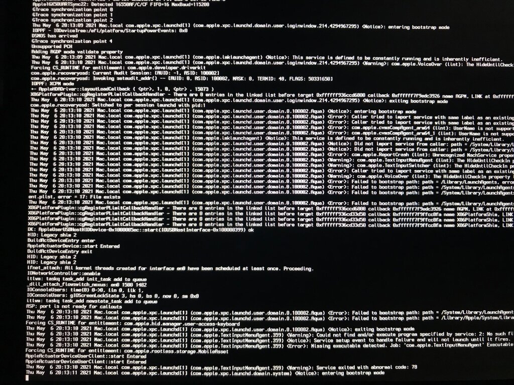

lfrey Posted May 7, 2021 Author Share Posted May 7, 2021 I replace all my EFI folder by this one but I didn't get the open core menu to show off. So I put back mine EFI and replace only the BOOT folder for start =>ok I can see back the opencore boot menu but that's not helping. Then replace the ACPI folder by yours an reload the config.plist with ProperTree => Still IOConsoleUsers error Replace the kexts folder with the properTree reload => got stuck still near IOConsoleUsers error Replace the config.plist by yours again with properTree refresh => the only boot choice now in the OpenCore menu is Windows. Link to comment Share on other sites More sharing options...

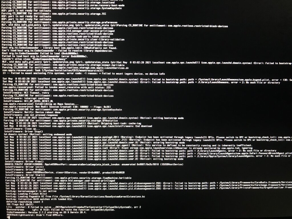

lfrey Posted May 8, 2021 Author Share Posted May 8, 2021 If I put all your EFI and replace part of the config.plist : from<key>Misc</key>..<key>Boot</key> to the begining of <key>Entries</key> => I'm able to see the opencore menu but stuck at an Lilu error now. Don't know if it's progress or not =/ Link to comment Share on other sites More sharing options...
Moderators Jake Lo Posted May 8, 2021 Moderators Share Posted May 8, 2021 add to boot arg -igfxvesa see if it boots completely Link to comment Share on other sites More sharing options...
lfrey Posted May 8, 2021 Author Share Posted May 8, 2021 I add -igfxvesa in both efi folder yours and mine, still a Lilu error in yours but with mine the GUI pop out but no keybord, trackpad. So I remove the igfxvesa in order to test for a proper acceleration config I change macbook 10.1 to pro 14.1(with mlb everythink) and change the AAPL,ig-platform-id value to : 00001E59 -> 00001B59 ->00001659 => stuck near IOConsoleUser everytime Link to comment Share on other sites More sharing options...
Moderators Jake Lo Posted May 8, 2021 Moderators Share Posted May 8, 2021 Graphics is not loading. You'll most likely need to set DVMT. Change SMBios back to MB10,1 and ig-platform-id to 00001E59 Add attach modgrubshell.efi to drivers folder and to Config file under drivers, set it to enable Boot to OC Picker, if modgrubshell does not show, then press the spacebar. Select it to boot At the grub shell, enter these 3 commands. You should be able to boot to graphics acceleration with -igfxvesa Setup_var 0x795 0x2 Setup_var 0x4ed 0x0 reboot Link to comment Share on other sites More sharing options...
