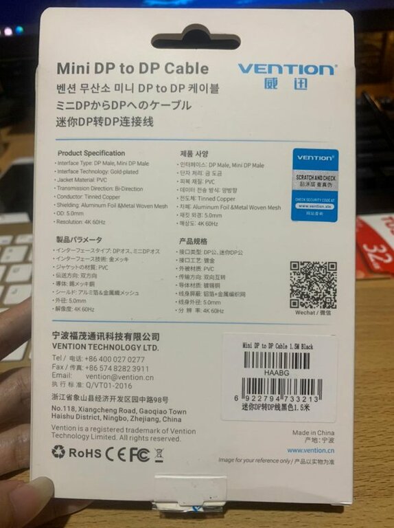

eagate Posted June 5, 2021 Author Share Posted June 5, 2021 im used this cable. i think it support 4K 60Hz in description product. i tested on Windows an work fine,but in my BigSur not. whats wrong ? Link to comment Share on other sites More sharing options...
Administrators Hervé Posted June 5, 2021 Administrators Share Posted June 5, 2021 Cable certainly appears to meet the 4K @60Hz specs so that's out of the way. Given that you're now using a DP-only nVidia card, your HDMI2.0 property injection for your iGPU is irrelevant and you should concentrate on nVidia dGPU properties. Consider injecting nVidia usual properties and envisage investigating the NVCAP matter; this defines the output ports. Link to comment Share on other sites More sharing options...
