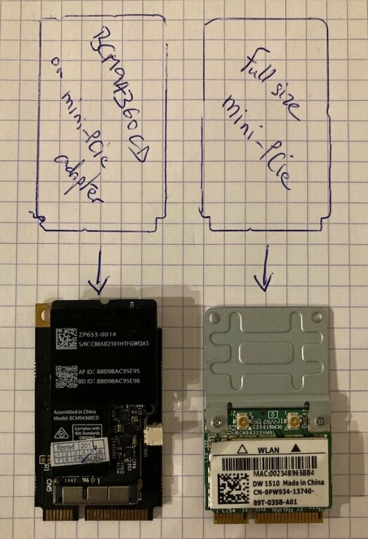

Administrators Hervé Posted January 8, 2022 Administrators Share Posted January 8, 2022 Well it does say DW1550 on it, doesn't it? But, unlike an Apple Card, it does not work OOB though... I've checked size of Apple's BCM94360CD on its mini-PCIe adapter (my leftover from the E6220 I sold last year) and it does fit exactly the size of a full-size mini-PCIe wireless card so I'd go for that. 1 Link to comment Share on other sites More sharing options...

Administrators Hervé Posted January 9, 2022 Administrators Share Posted January 9, 2022 Very old stuff my E6440 guide and research work but, yeah, those were the days... Yes, this is the kind of adapter you need though you should be able to find it for much cheaper. Look it up. To illustrate why you should feel safe about the BCM94360CD on a mini-PCIe adapter re: space/size: 1 Link to comment Share on other sites More sharing options...
