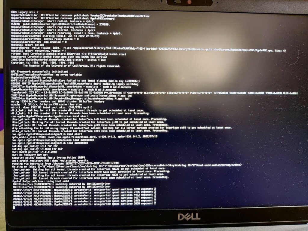

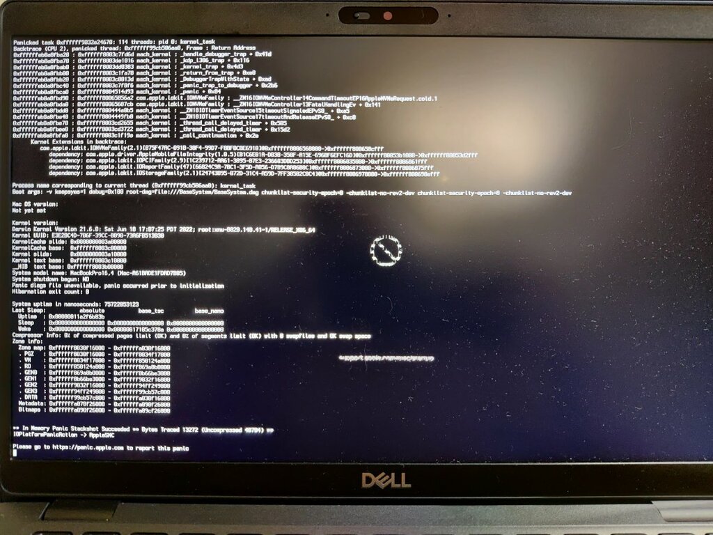

28weekslater Posted August 12, 2022 Share Posted August 12, 2022 Hello, I try to install MacOS Monterey on my Dell Latitude 5401 but, unfortunatly, it's not work. I try the EFI folder on the another topic talking about the 5401 but, don't work. First, here si the configuration of my Latitude 5401 : - cpu : Intel i7-9850H - ram : 32Gb - gpu : Intel UHD Graphics 630 / Nvidia GeForce MX150 (can't disable this one on the bios...) - ssd : Micron 2200S NVMe 512GB - ethernet : Intel Ethernet Connection (7) I219-LM - wifi : Intel Wireless-AC 9560 160MHz If I try with the EFI folder submit in other 5401 topic, see the error in attachment. If someone could help me, please Have a nice day ! Y Link to comment Share on other sites More sharing options...
Administrators Hervé Posted August 12, 2022 Administrators Share Posted August 12, 2022 Thank for posting your specs; always most useful (to to say mandatory), especially in your particular case! You have a Micron 2200S NVME SSD. This model is not compatible with macOS (cf. the Dortania Anti-Hackintosh buyers guide) and you may have noticed the Kernel Panic on IONVMeFamily driver; there's no fix or workaround, you'll have to replace that SSD by a fully supported model if you want to install and run macOS on your laptop. Link to comment Share on other sites More sharing options...

28weekslater Posted August 21, 2022 Author Share Posted August 21, 2022 Hi ! I change the ssd today by a Samsung 970 Evo plus. I try to boot on my usb key but... As you can see on the attached picture, it doesn't work... Link to comment Share on other sites More sharing options...
